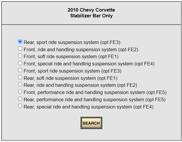

I found a rear Z51 (Fe3) sway bar at: https://www.gmpartsstore.com/. They don't have the front, the bushings or end links, as far as I could tell. When I looked for the front, they listed the FE3 bar as discontinued. Hope this helps.
The B6 Bilsteins are easy to find, as are the end links.
I already have the B6s ordered. The rear Z51 is what I'm looking for. Apparently, the front sway bar is the same as the Z06 sway bar. The only difference between the two sets is the rear Z06 is designed for wider tires than the Z51s.

I cannot find the Z51 sway bars anywhere. Everybody is out of stock or back ordered. Anyone know where to find them?
I believe Hotchkis and Steinjager both sell a Z51 comparable swaybar set for under $300. I know several members of this forum went with Steinjager when the OEM swaybars became hard to find, maybe one of them will chime in.
You don't want to run the Z06 rear bar on a narrow body C6 as it can lead to oversteer when nearing the cars limits, which is unwelcome. Or at least that's my experience/opinion. YMMV
