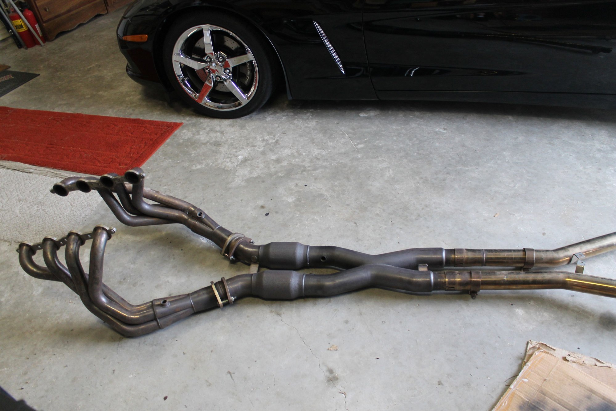

Here's a photo of Kooks LTs, you can see the upstream bungs in the header collectors:
To o2 sensor question
