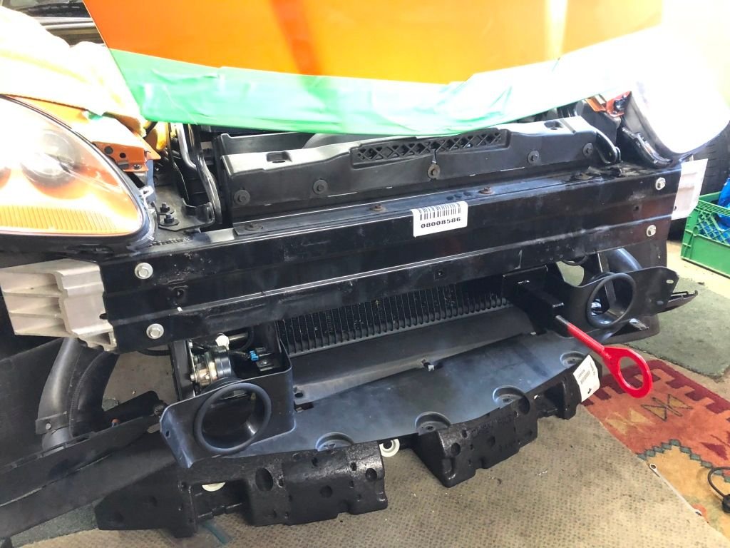

well, I do track the car and first thing I did was add brake ducting and since the bumper was off anyway (first of many times), I added a screw-in tow hook as a matter of course.
I think this may well be the only car I've owned that didn't have one...I thought because of the aluminum frame. But steel frame C6s don't have one either.
Anyway, its handy to winch the car on my trailer.
It's good to know that a competent flat bed operator can get the car up wothout using one...although in my case, with the current protruding splitter, it would be an issue
Obviously, i remove it on street, lest it be the first point of contact if bumped.
