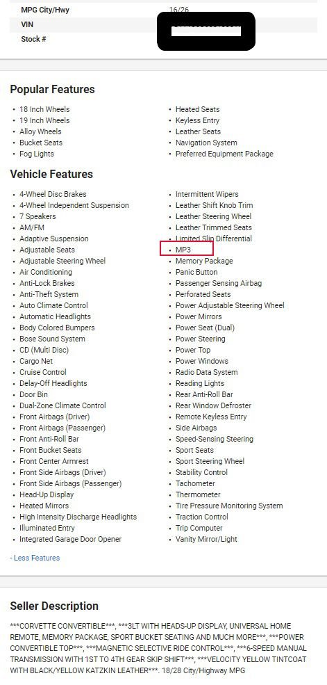

I have two other vehicles that say they are MP3 capable and with those two, I just burn my MP3 music onto a CD and they both play them with no problems....No so with the vette....put the disc in and it says "NO CD FOUND" What am I doing wrong or what am I missing here?

Beginning on page 3-93 of the 2006 Owner's manual is a section on Using an MP3 CD. This section documents the procedure to burn and play MP3 CD's. If you have followed everything shown there, I don't know what else to tell you. I assume you have an OEM head unit.
