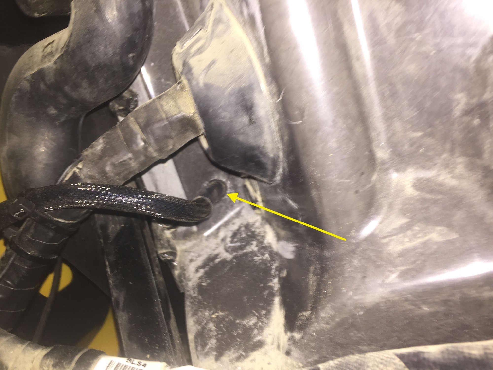

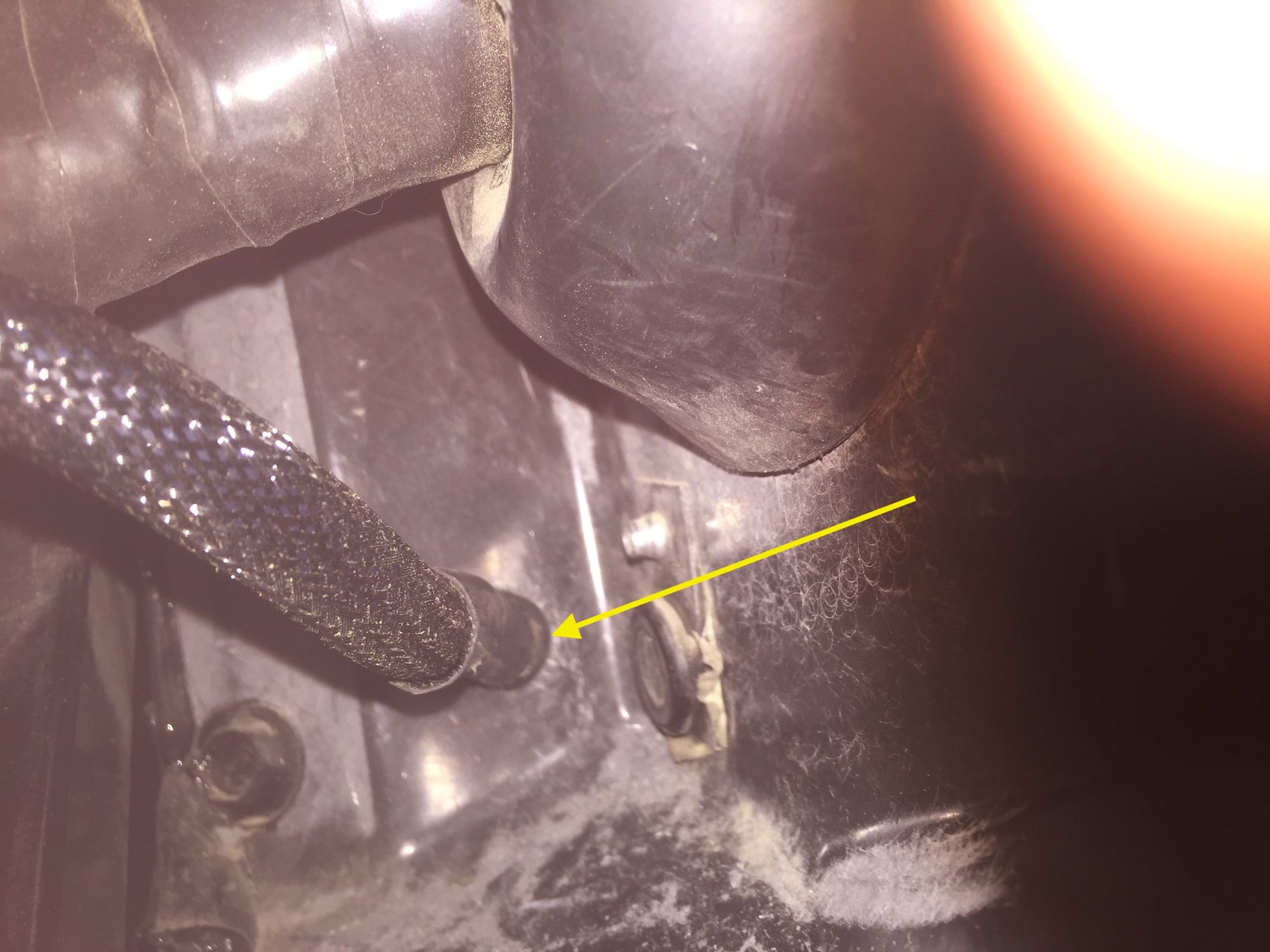

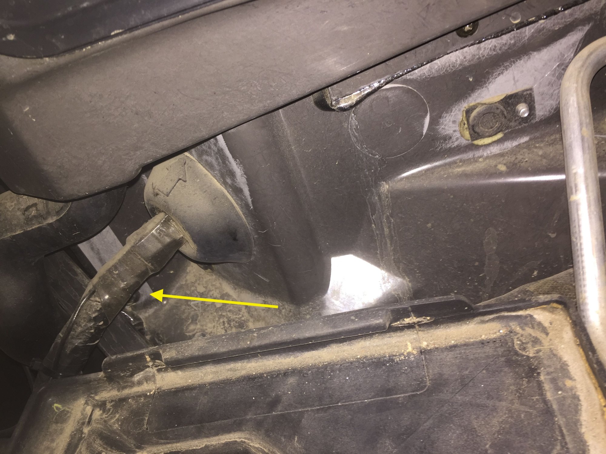

I had to run power for my sub amp, I carefully drilled a hole in the location shown in the pictures, I also added a grommet to seal it. This area is behind the battery by the main harness I believe you're referring to, you can see the battery tray at the bottom of the first picture. However I did run my camera wiring through the main harness grommet, but it was a real pain to get it through.
