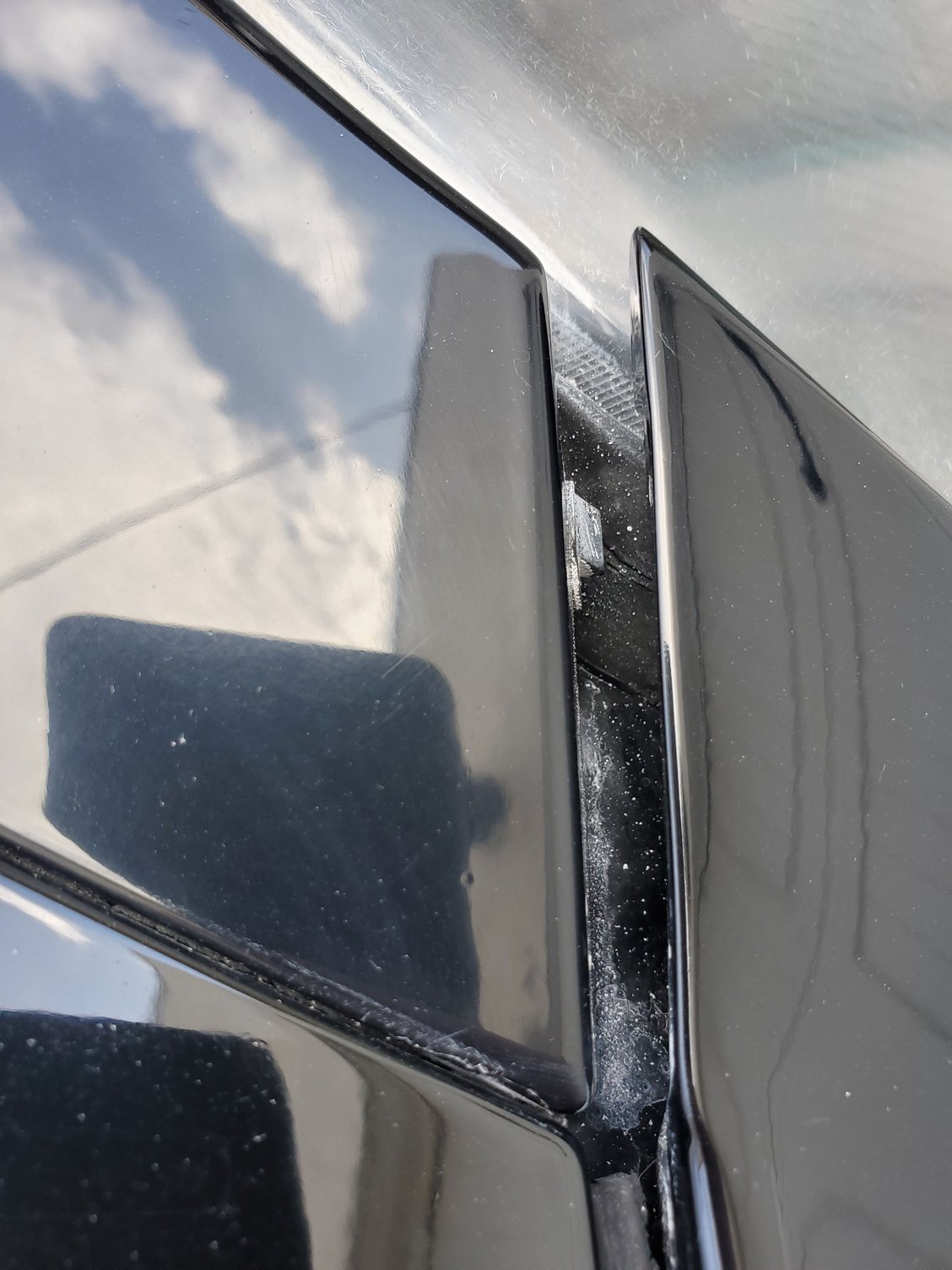

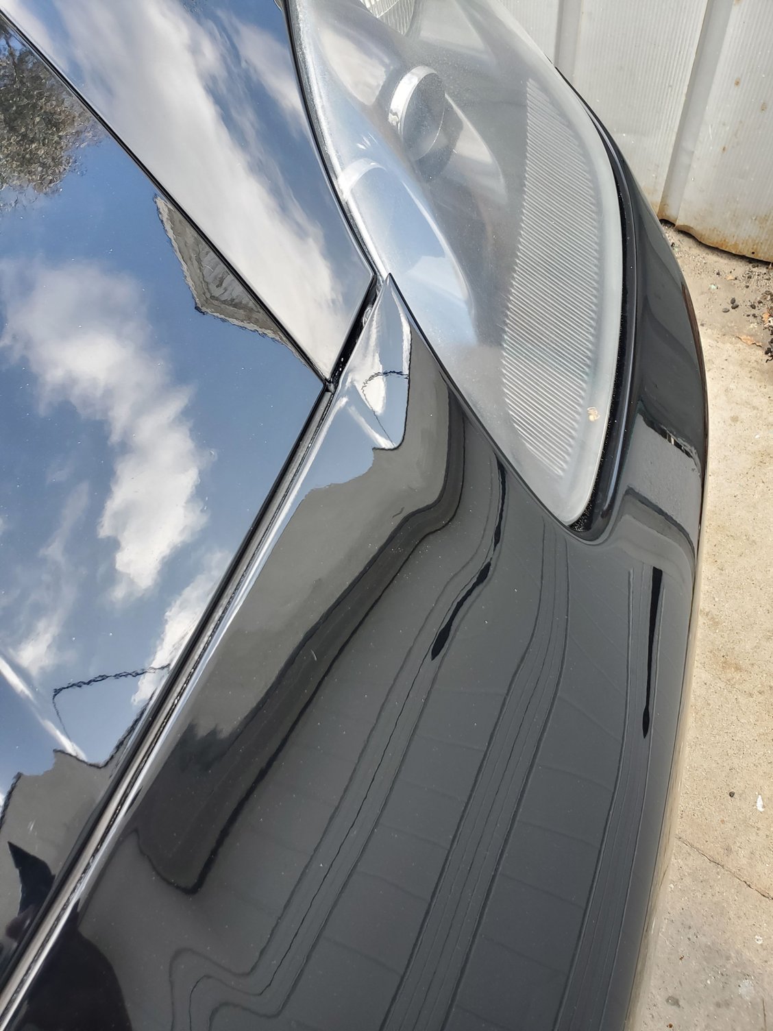

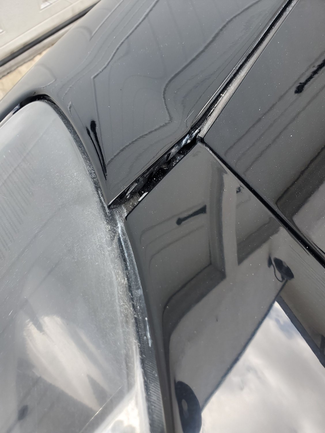

Hello,
can anyone tell me if I am having a body panel alignment issue, or if I am missing a clip of some sort? The other corner doesn't lift up like this one. I went through the parts catalogue but wasn't able to locate what I might be missing to keep that corner down.
Any help is appreciated.

Car is new to me. 2007 C6, Z51
some progress:
Before
After

link below to what you need..........................
https://www.corvetteforum.com/forums...icking-up.html
you can use the search feature here for fender clips and find numerous posts about this topic
may be able to source them from Amazon too

Thanks! I didn't know it was a "fender clip", so wouldn't have thought to search that phrase. I appreciate the help.
