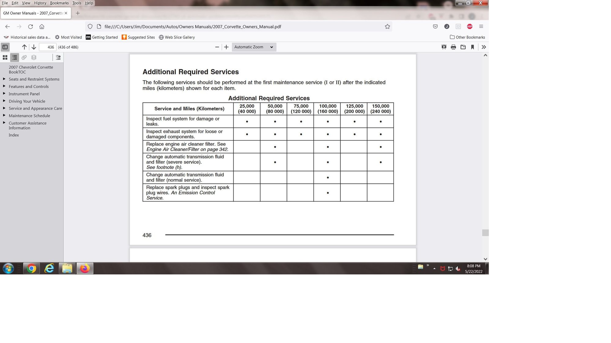

Page 436 of your 2007 owner's manual says you should change the transmission fluid every 50,000 miles for severe service or every 100,000 miles for normal service.
