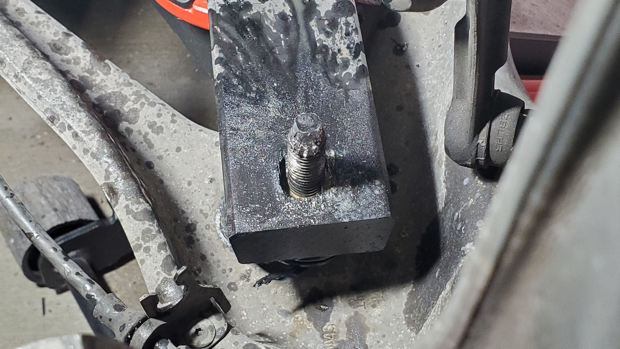

I got all 3 corners done, then the front passenger head stripped on me. Anyone got some advice on how to get those bad boy turning again? I got two nuts (lol) I found that thread, and I tried using them against each other to turn the bushing bolt but both nuts turn, even when I tighten them against each other as hard as I can. Do they need to be opposite threads?
Also, the front turns off the same way as the rear, right? As in - if I'm sitting at the passenger front wheel, I'll turn the bolt clockwise to "raise" the car. I'm not trying to lower it. It's currently max lowered. Running out of ideas here other than to weld a nut to the top of it. But I don't have a welder, so id need to buy one.

Probably better ways than what I'm going to say, but have you tried hammering a slightly smaller 6 point socket onto the end and trying to turn it?

The bolt is dead center of the shock, so I can get a socket on there, but then I can't get the wrench because the head of the wrench hits the shock.

First of all, a 6mm would be way too small, the correct size to try to hammer on would be 3/8, as the normal size is 10mm. Yes, the fonts turn the same way as the rear. I don't think a welder is necessary. Using 2 nuts should work, maybe you're not doing it right. Use 2 nuts of the same thread as the adjuster. The idea is to tighten the 2 nuts together, then put a wrench on the bottom nut if you want to screw the adjuster up, or the top nut it you want to screw it down. I would expect the threaded insert in the spring to turn before the nuts slipped. Also, it looks like the rubber on the adjuster is getting pretty rough, might want to consider replacing it. Another thing you can do if the hex isn't too bad is to file it down a bit so a slightly smaller socket will fit

Do you have the upper control arm, shock and tie rod disconnected? Then turn the leaf spring bolt from the top like you’re going to tighten it, because it comes out through the bottom.

the two nuts then just act like a single nut and keep working their way down the shaft when I tried this. Filing it down was an option I thougt of too

Yeah that's how the top got so mauled up. Vice grips just chewed right through the metal before turning it

No it's all still together. I considered taking the shock out but haven't gotten to that point yet

Take a dremal and cut a slot in the top for a driver
or file down the sides to a smaller sized socket. Pull the strut out of the way and remove/replace the bolt
as someone else pointed out the rubber on yours is pancaked you’ll want to put some new ones in

Removed the shock, tried to go at it from the top. Nothin, just stripped even more. Leaning more towards welding at this point? And to confirm, this needs to be turned CLOCKWISE to get the bottom cup to push out (raise the car)...?

Looks to me like there is plenty of meat there for a 6 point 10mm socket to drive that screw. What kind of wrench/socket are you using? Threads are right hand just like most everything else.

Silly question. But do you have pressure off of the bolt from the spring? By raising the spring up to release the pressure.
Doesn’t look like it in your pic.

6 side and 12 side 10mm just spin freely - 9mm wont quite fit. I tried hammering it on but it just stripped too when I started applying pressure

Yeah there is, I can fit my finger under the padlet. The jacks pushing up on the leaf spring in that pic just kind of hard to see.

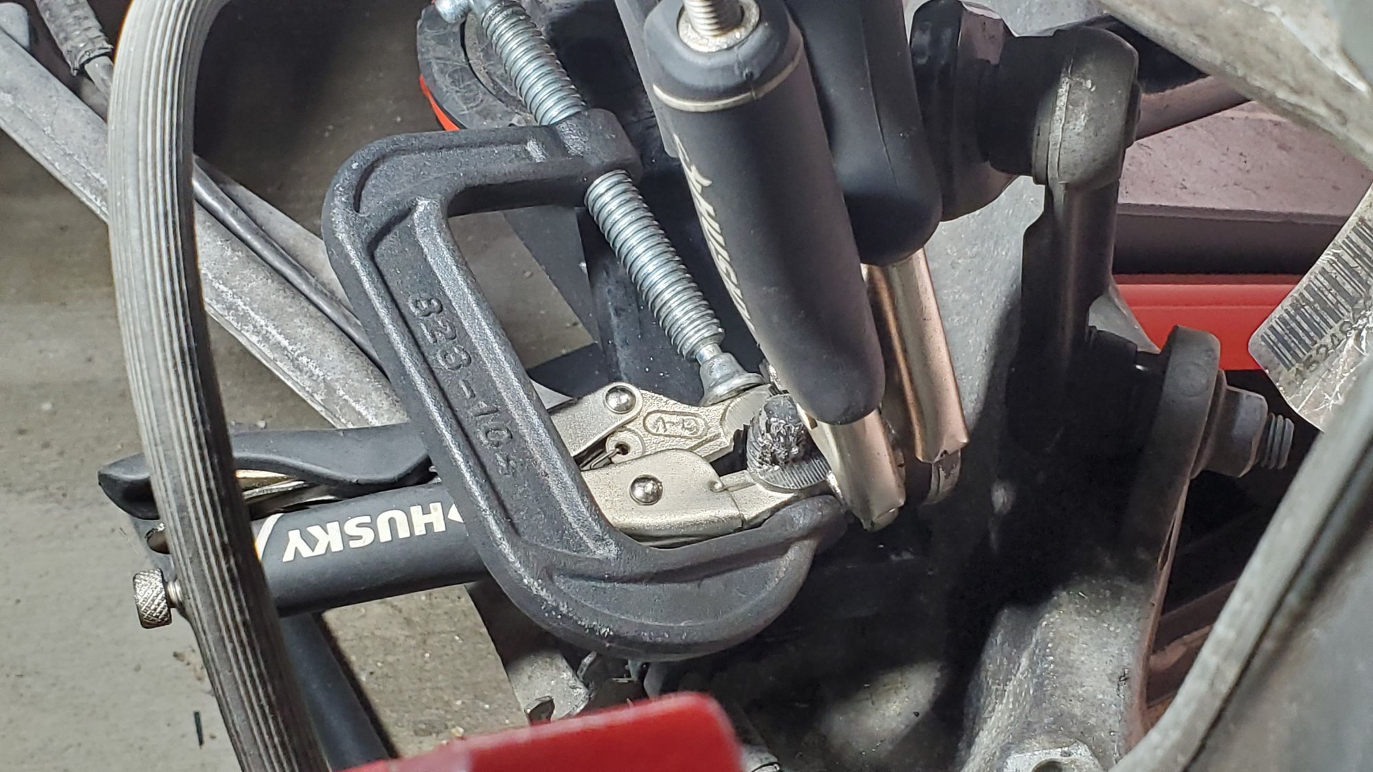

Threw in the towel on it. I came up with this monstrosity. Back against the wall and leg pressed it and then the entire leaf spring started turning. Not up and down, no the leaf spring started twisting back like it would sheer. I guess my cars staying maxed low until it's taken in for the rear main seal. At that point I'll have them replace all 4 - the front driver has ZERO bushing left, it's just the metal base. Threw some grease on it for the meantime. I left the back up, slight rake now . Gained about an inch of height in the rear.
