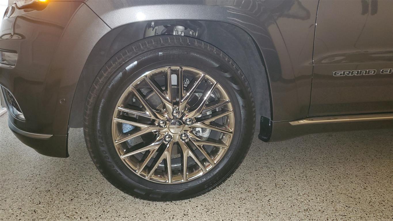

If those ZR-1 rims are replicas, then I guarantee one (or more) is not 100% round. This is why I would never buy replica wheels (which I know came with the car, so it's not your fault).
You can buy used OEM wheels from Detroit Wheels (that's where I bought my chrome Grand Cherokee Summit rims - Jeep doesn't offer these in chrome). I have no affiliation with them...found them via a Google search and discovered they take OEM rims in on trade, chrome/black them and re-sell. They ONLY deal with OEM rims. Give them a shot. The rims for my Jeep look AWESOME (and they have that ZR-1 look )
