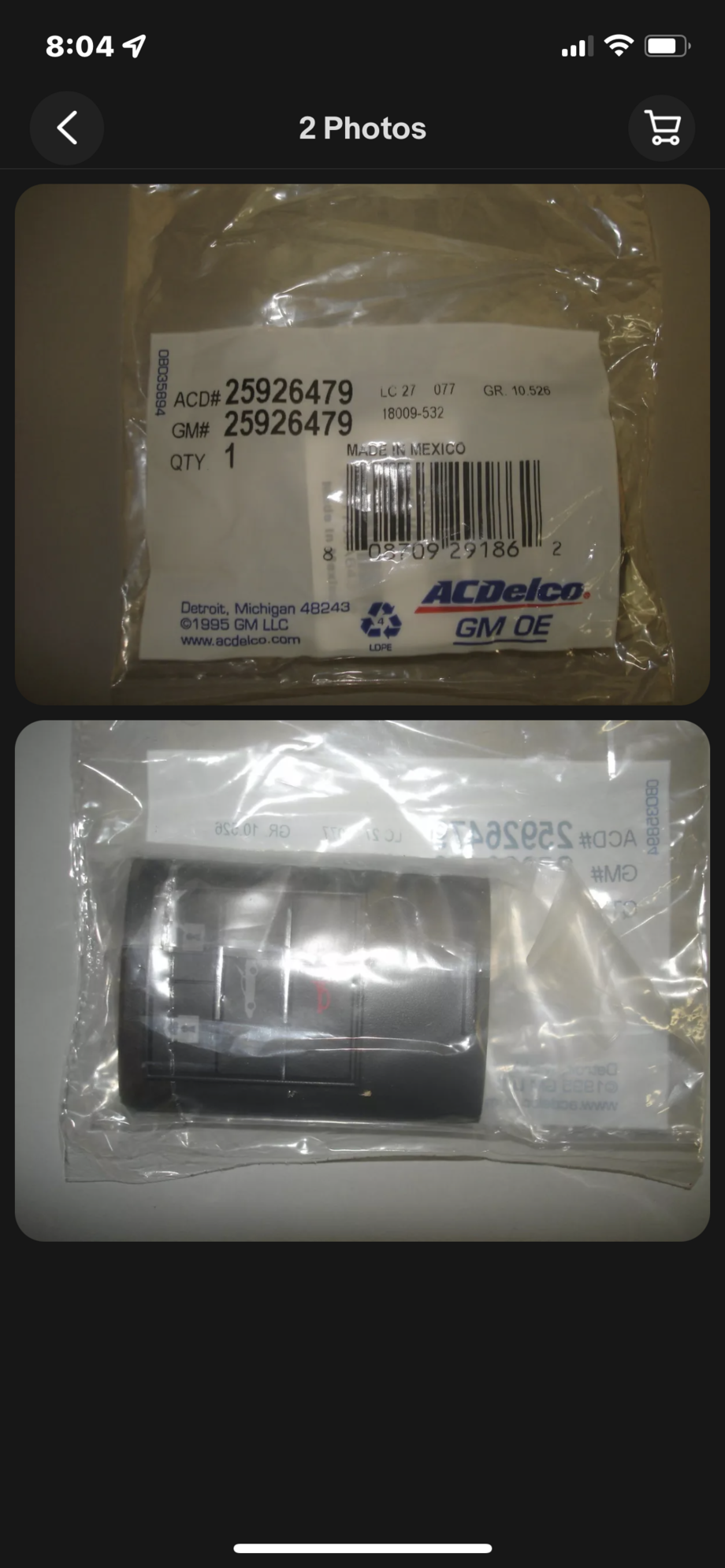

Thanks so much this place is always helpful. The reason I wanted to replace the driver 1 Key Fob transmitter is mine is cracked just the case of course it was my fault I dropped it. It works just fine. Purchased an OEM GM # 25926479 from Ebay for $99.00 I really wanted to keep driver 1 so I'm go to just switch my transmitter into the new case and keep the new transmitter for a spare.
