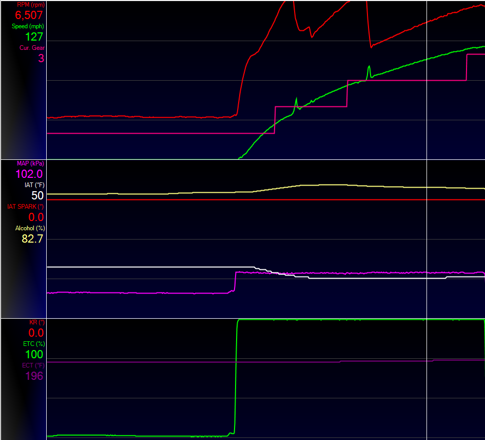

This right here! The vararam actually works and on an efficient enough combo, you'll actually see positive manifold pressure from the ram air scoop of the vararam forcing air into the car.
Here's a picture of a log of my C6 with a vararam. Notice the MAP sensor is at 102 KPA which is 0.2 psi of positive pressure.

So...how many of you, honestly, could understand the above graphic? I think the OP is looking for what we feel is best. He is not looking for complex graphics that explain nothing to a layman. But, for those who do understand it, asd has given graphic evidence.
Though it is not a majority, the most-often recommended CAI on this forum is the Vararam. Many feel it provides real-world benefits.

Some will understand it. That's why I also made the point of explaining what the KPA is showing as positive pressure, also proof as to it working not a feeling it works. Can't argue with data. Does it work? yes absolutely. I just didn't want to provide the typical " i have one i think it works" answer when in reality most the time the people think something works but have no data to support the claim.
