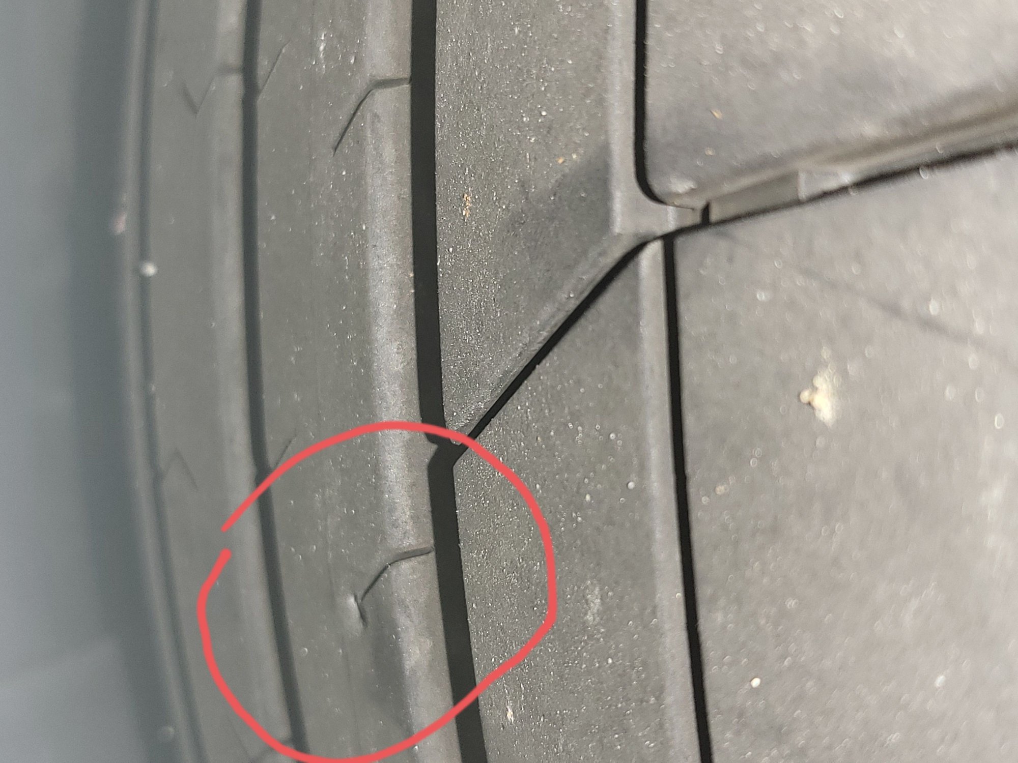

I've read numerous varying opinions on to repair or not repair run-flats, it seems very mixed. Overnight my right rear went flat in the garage, 6 PSI. I can see the nail hole, it's pretty small, center tread, maybe 2-3mm. The tire is a Continental Extreme Contact 285/35ZR19 run flat (300$+). 13000 miles on the set and car, tread still good, '05 base C6, owned for 3 months. Please, someone advise me, I'm stuck in my garage, no compressor, jack or no spare. I do have AAA so thats nice; last car I had same thing happen, they came to my house and patched/inflated it there for 20$ no issue, but that wasn't a run flat and I shudder at the idea of this lowrider going up a flatbed.
I do have a "express road hazard tire coverage" warranty for 3 years that came from the dealership (via third party), which, I dont know what that covers or how long that will take, they're also 60 miles from me and they messed up my car many times "working" on it, I really dont wanna have them touch it. Really hoping I can have it repaired at a tire shop or my house and not have to deal with the delays and telephone games from both parties. What would you guys do?

That’s a patch job for sure. Find somebody with a jack and a stand that can come over and lift up that corner and just take the wheel over to a place like discount tire. They repair nail punctures for free as long as it’s not near the sidewalls. Since you said center tread you should be good to go.

The strength of a run flat is in the sidewall, so yeah, I'd patch it.
Get yourself a jack and jacket ands at harbor freight, take the wheel and tire off, take it to adiscount tire or amerocas tore, and theyll patch it. Do not have it plugged. Have it patched.
In before someone tells you that you're tires are probably too old and are likely to grenade and wipe out a city block and so you need to replace them anyways.

First thing: Continental does NOT make a run flat for the Corvette
Second thing: A nail, screw etc. does not leave a "slit", it leaves a round hole. And most times the nail, screw etc. stays in the tire.
Third thing: Everyone should carry a small air compressor that can be bought for around $25 even if they have runflats.
Fourth thing: If it's a "slit" it can probably not be repaired

Well, I see your point on the run flats. Doesn’t make sense! I thinking when you saw the tire flat on the ground, you thought what the heck, are you sure it’s a run flat? Somewhere on the tire it will say “run flat or zero pressure “ check it out. Why can’t you just drive it to a repair shop if they are run flats? Using the patch is the best way to go. Hopefully none of the supportive steel used is not damaged but a little hole like that I doubt it. The more I look at the picture, you are showing a slit more than a hole , you sure that’s were it is leaking? Wet it and see if it bubbles. Usually a puncture has what punctured it still there. Good luck
