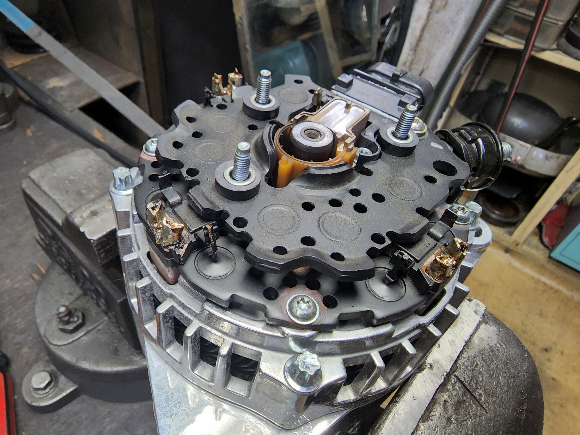

I replaced the Mechman 170 Amp about a year ago.
There was no abnormality until a while ago, but recently, in the summer, there was a strange symptom that suddenly fell to 11v and then went up to 14v again.
The symptoms occurred for about two weeks, so I replaced the start motor and the battery, but the symptoms continued to appear.
It was a pre-alternator symptom before the alternator failed.
The symptoms continued to appear for about two weeks, but on the last day, it no longer went up from 11v to 13v, and 11v continued to appear.

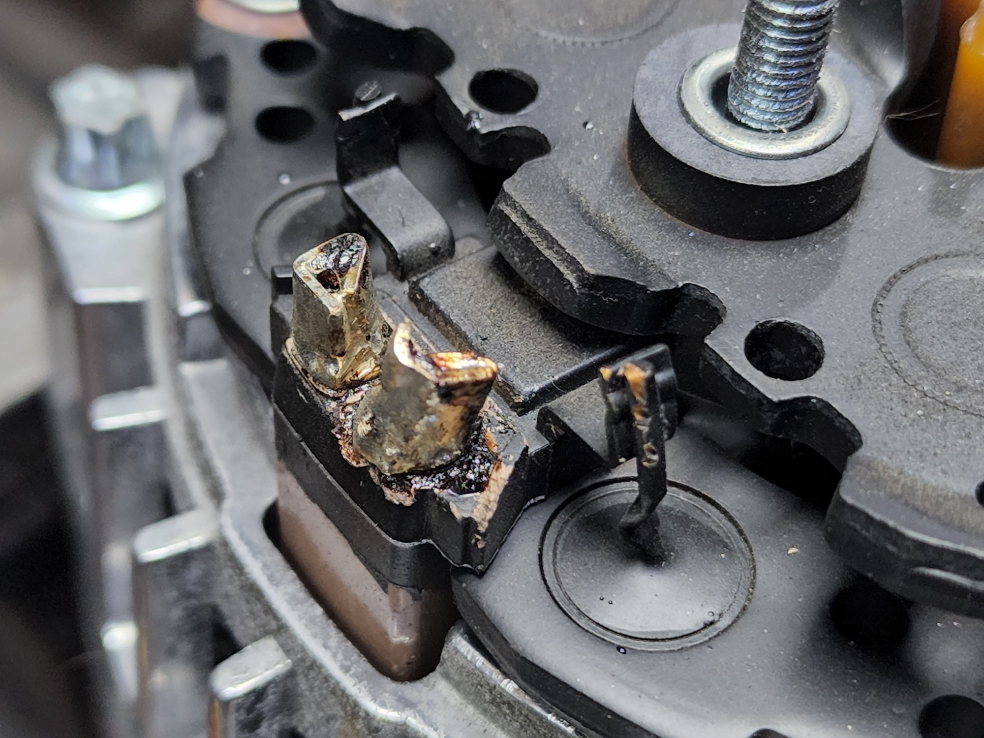

I went to the maintenance shop in a hurry and the alternator broke down. So the symptoms disappeared after being replaced with a new alternator.
I've been using it for about a year and it's already broken
I visited the shop to repair the alternator and opened it, and the contact part was burnt and melted.
I am disappointed that the Mechman alternator is only this durable.
I couldn't get the AS because this is Korea. So I sent an email to the person in charge and asked him to let me buy a regulator because I would repair it here, but he was rejected.
The symptoms of your car are the same as mine. Get it repaired before the alternator is completely broken.
