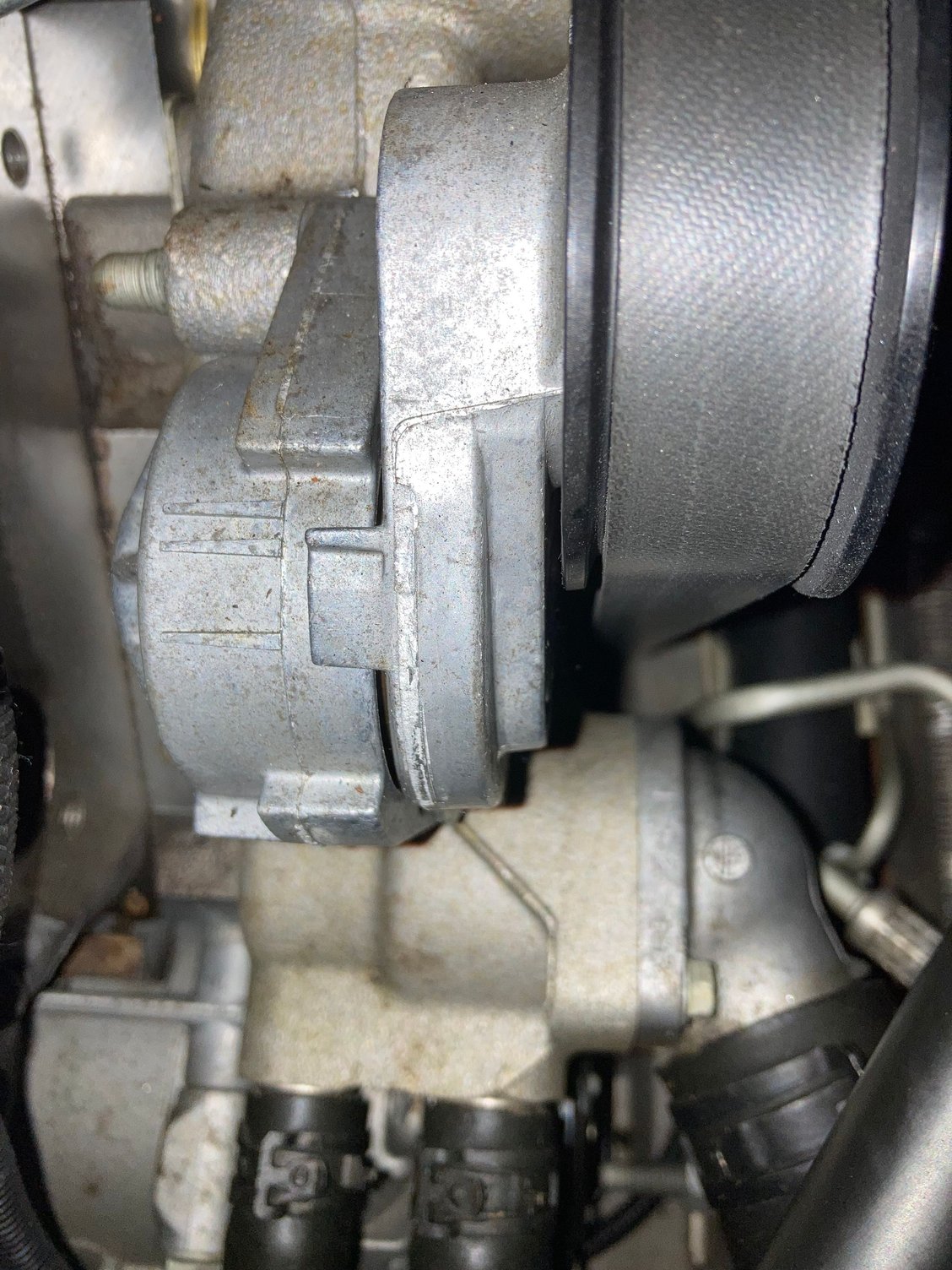

Sorry to hear this. I would definitely take it back to the shop, something went wrong. Do yourself a favor and look at the belt tensioner that is located on the passenger side of motor. There are indicators on the top, see photo, this will tell you if the belt is too loose, you want the center indicator to be as in the photo or close to it. This is only one thing you can check among others. Just hope the shop can help you out here. The a/c is a separate belt, sometimes those belts will slip and not squeak. As for the off center steering wheel, the shop did something wrong with that. They should of noticed this and advised you to get an alignment. Also check that you got the same diameter balancer.
Good luck
