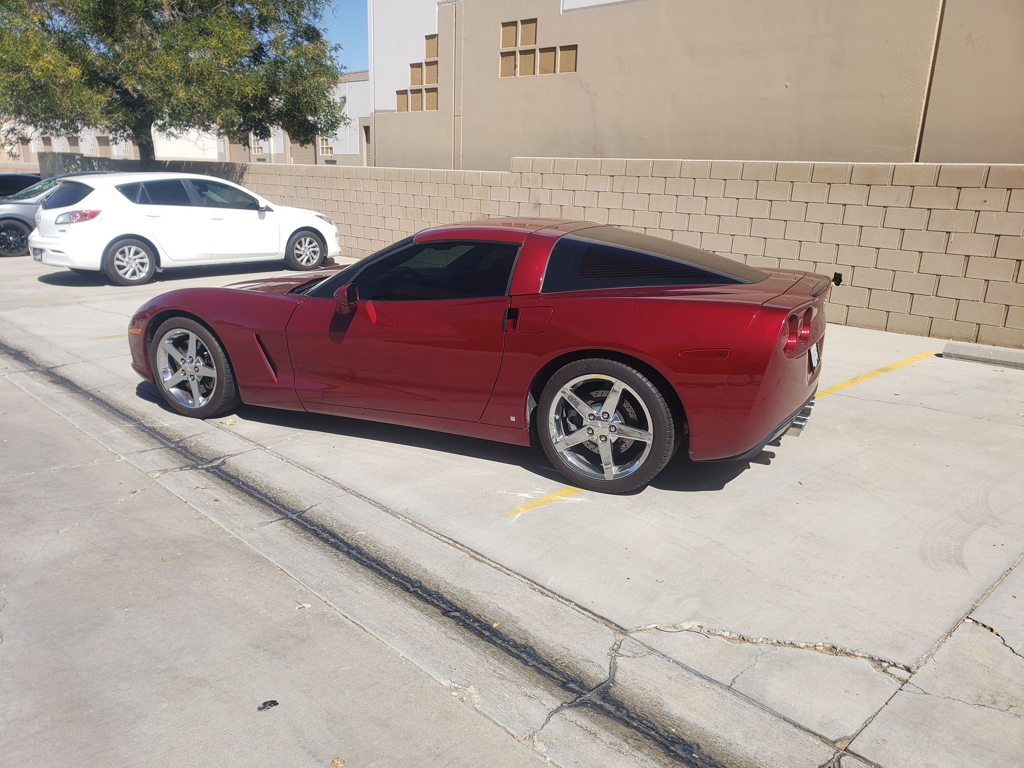

Found a local place that knew the car and has been in business since 87. 15% tint, turned out decent.
Thanks everyone for your input!
Dots...they were well aware of this and pointed it out to me and compared it to another vehicle they had tinted so I would know what to expect.

Looks great. Glad you found someone experience and willing to do it.
