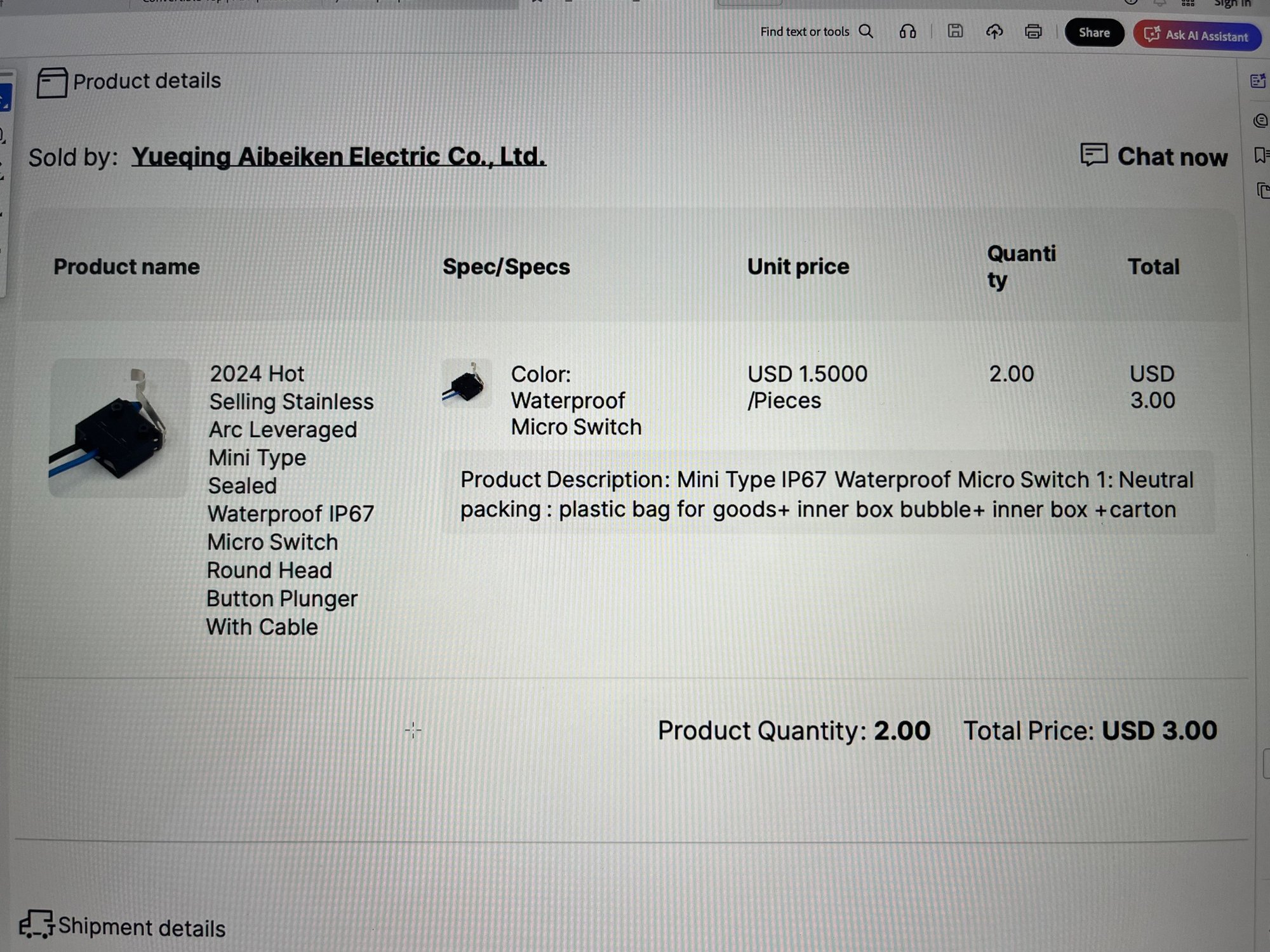

It is the #5 position switch and I bought one from Alibaba today and we will see how big it is when it comes in. I also bought 10 micro switches from amazon and will try to Make it work too. The wiring can be changed to plug into the prong versus wire coming out of it. Dino's corvette salvage will rebuild yours for $200, but I think I can do it too. Oh well I have 5 months before the top needs to work so I'm sure I can get it done. does your position switch #5 has the metal thing on top of the plunger?

On that 5th bow switch issue, the Vette mechanic at the dealership diagnosed that for me. Personally, I've not had it out but that's on the list of things to do. As far as Dino's repairing them, it's still on their website but when I talked to them (actually twice) the guy I talked to said they haven't done them in a while because they've not been able to get replacement microswitches.
As far as that 5th bow switch goes, it causes a "Top Not Secure" msg, but all you have to do is hit the reset on the dash and it goes away.
If you do get a functional replacement switch, I'd love to know where you got it along with the info on the switch. Thanks.
