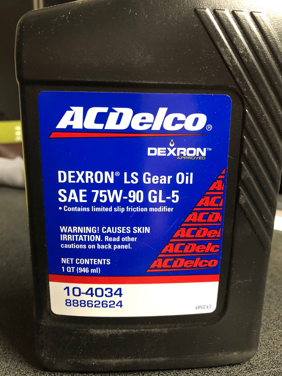

Can the Dextron 10-4034 be used in an 06 vette??

I believe so, this is what I used for my 09. Don’t see why a 06 would be any different.

Yep thats the right one

2005 Mn6 z51, I purchased a top quality lube, and a short time later I got noise from the diff. I switched to the GM LS lube mentioned above. A couple of figure 8's and a short drive later and thereafter no problems or noise.

Never mind, I found it, 3 quarts needed, diff requirements are just over 2 quarts and I always let's some new fluid drian out anyways.

I just did this and two quarts was enough with a little leftover. I went with
Mobil 1 104361-UNIT 75W-90 Synthetic Gear Lube.
