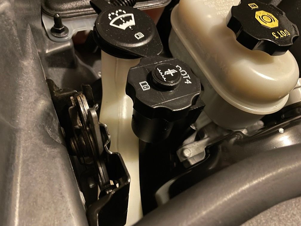

This is what the new GM one looks like (on my 2011 Grand Sport); black reservoir, Dot 4 on the cap:

The white master cylinder reservoir is the old one. The black reservoir is the updated one.
As far as bleeding the system, that is not needed. The new master cylinder comes with clutch fluid in the part. Any air bubbles in the line eventually float to the top into the reservoir. Although many here would prefer that Chevrolet did provide a fluid bleed feature. As an HPDE driver I am one of them.
