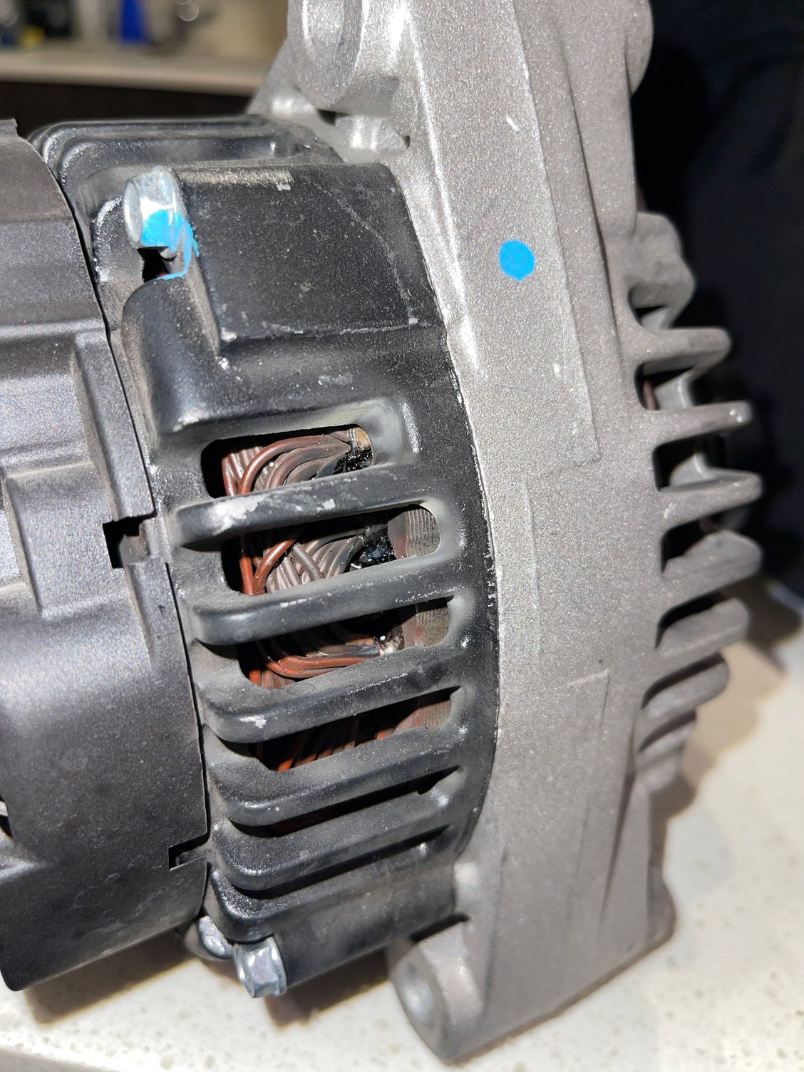

Old Jan 20, 2023 | 09:01 PM
farjam.haida's Avatar
farjam.haida
Joined: Jan 2023
Posts: 50
Likes: 16
From: Central/ Eastern Iowa
Default Thank you everyone!!!
Definitely was worried about nothing, looks like the alternator just melted as u can see in the pics. Hopefully she’ll be back on the road soon!
