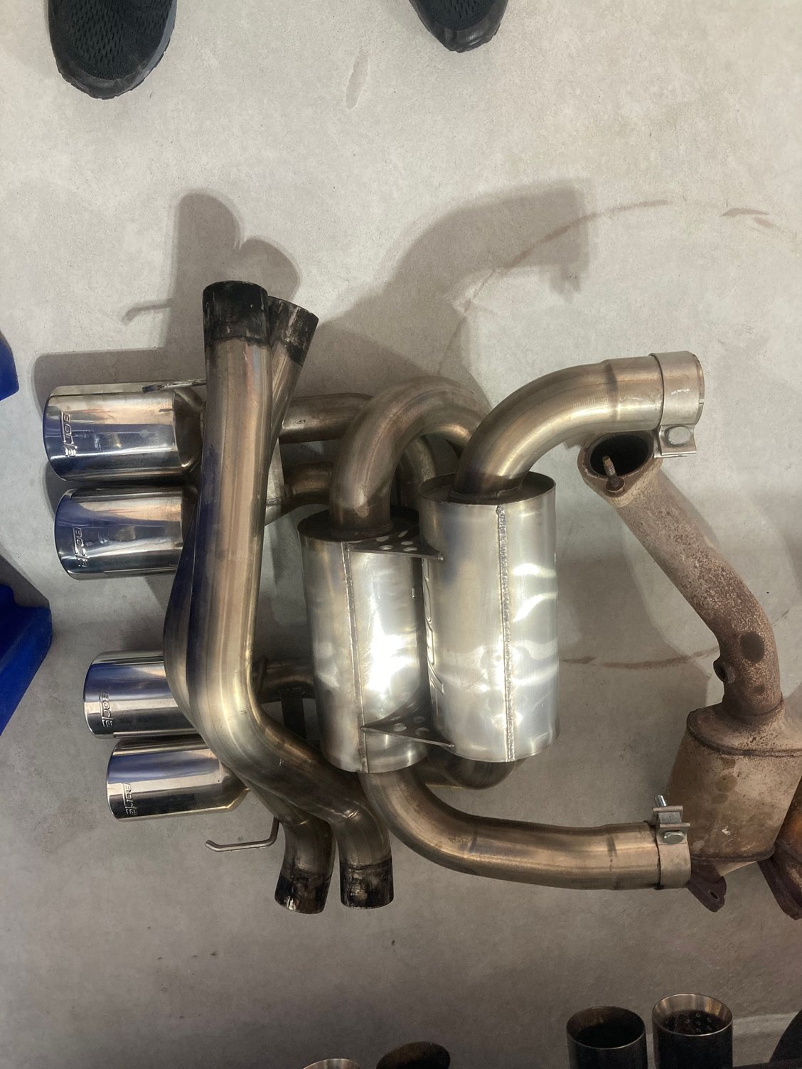

Here You Go <<<< Check out the Parts For Sale/Wanted Section
I never heard of these headers before.
It was weird, after reading your post and these were the first listing in the For Sale Section........so I threw it up here for you to see.
I personally am running 1 7/8” Kook long tubes with hi-flo Cats & 2 ½’ Mid/Xpipe & Corsa Xtreme
