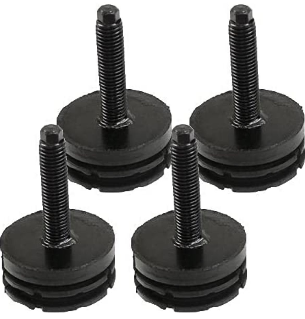

You didn't mention mileage, but I suspect your ride height adjusters may have the rubber pads worn off (there are various options to replace them).
Also, you don't say if the car is actually bottoming out ...which may point to shocks being blown
I'd start looking there

Posts: 13
100k mileage. Are you referring to these to be replaced?
