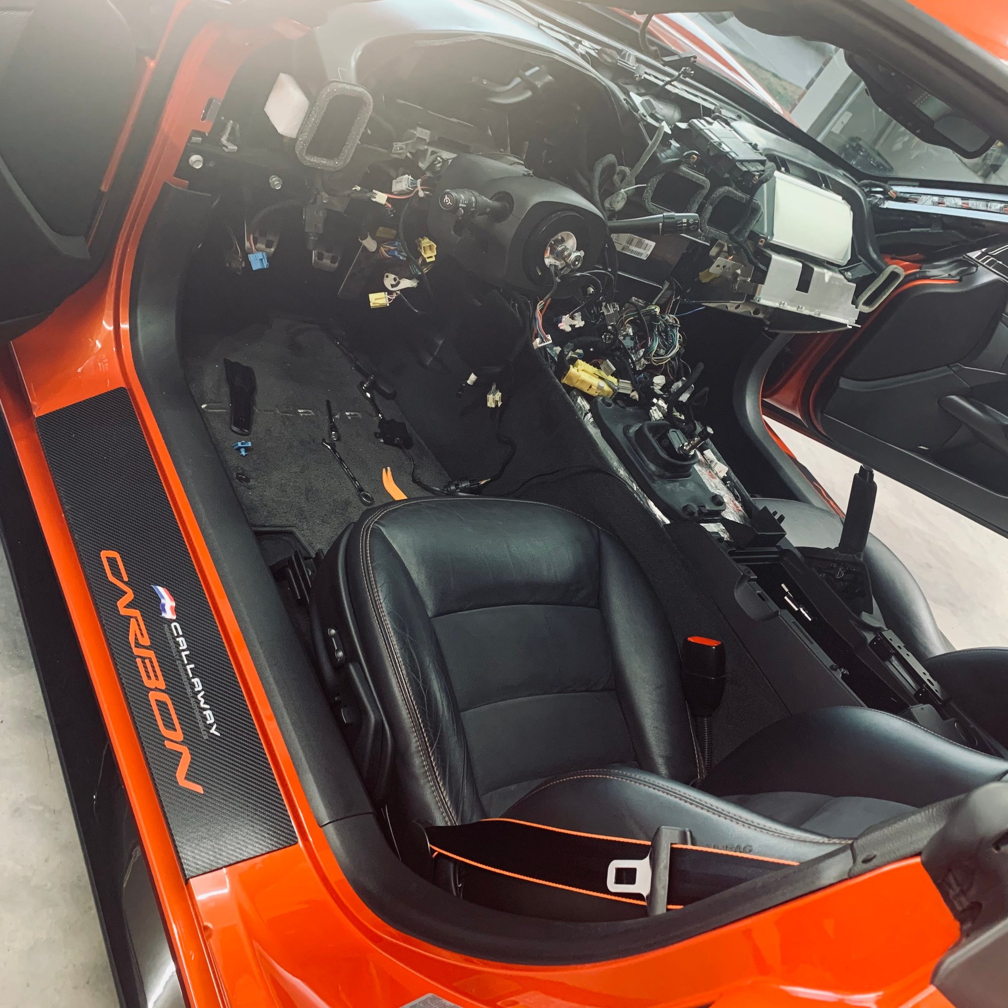

Literally a million threads on this. Google is your friend. Known issue & you'll need to remove the dash to fix it or have it fixed correctly. Removing the dash isn't difficult, takes about 1-2 hours depending on your level of mechanical ability.
http://www.kawal.net/Dash%20Replacement.htm
* while you have the dash out I would strongly recommend you take your HUD projector out and reinforce the screws that hold the mirror assembly as the plastic tabs tend to break and the mirror falls into the unit thus making your HUD useless. It's really simple with the dash out, just remove the a/c ducts on top of the dash, remove the projector, open it up and put washers under all the screws. Then put it back in

Why risk it, windshields are expensive. Taking our time sorting and labeling every screw, nut, bolt, push pin, etc., it took my 10 year old son & I about an hour 45 to remove the dash. Took about an hour 20 to put it back in after the dash was fixed. Cost $365 at a custom auto upholstery shop to condition, stretch, and re-glue the leather. Tbh, I could've done it myself knowing what was involved.
I've see quotes posted here ranging from $1,000 - $3,000 to have a shop do this repair. It's honestly not that difficult. The majority of that cost is to R&R the dash.
