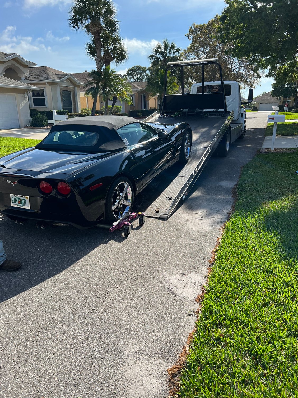

Something I feared many years ago happened to me. My 2007 corvette auto trans cable went. I used the car the day before and pulled it into my garage and put it in park. Every gear feels like it’s in neutral. I’m having a flat bed tow it out of my garage to my service station which is 3 miles from my house. I’m hoping it can be pushed out of my garage . It has 32000 miles on it but the plastic over time degraded. Just venting at GM design of the cable!

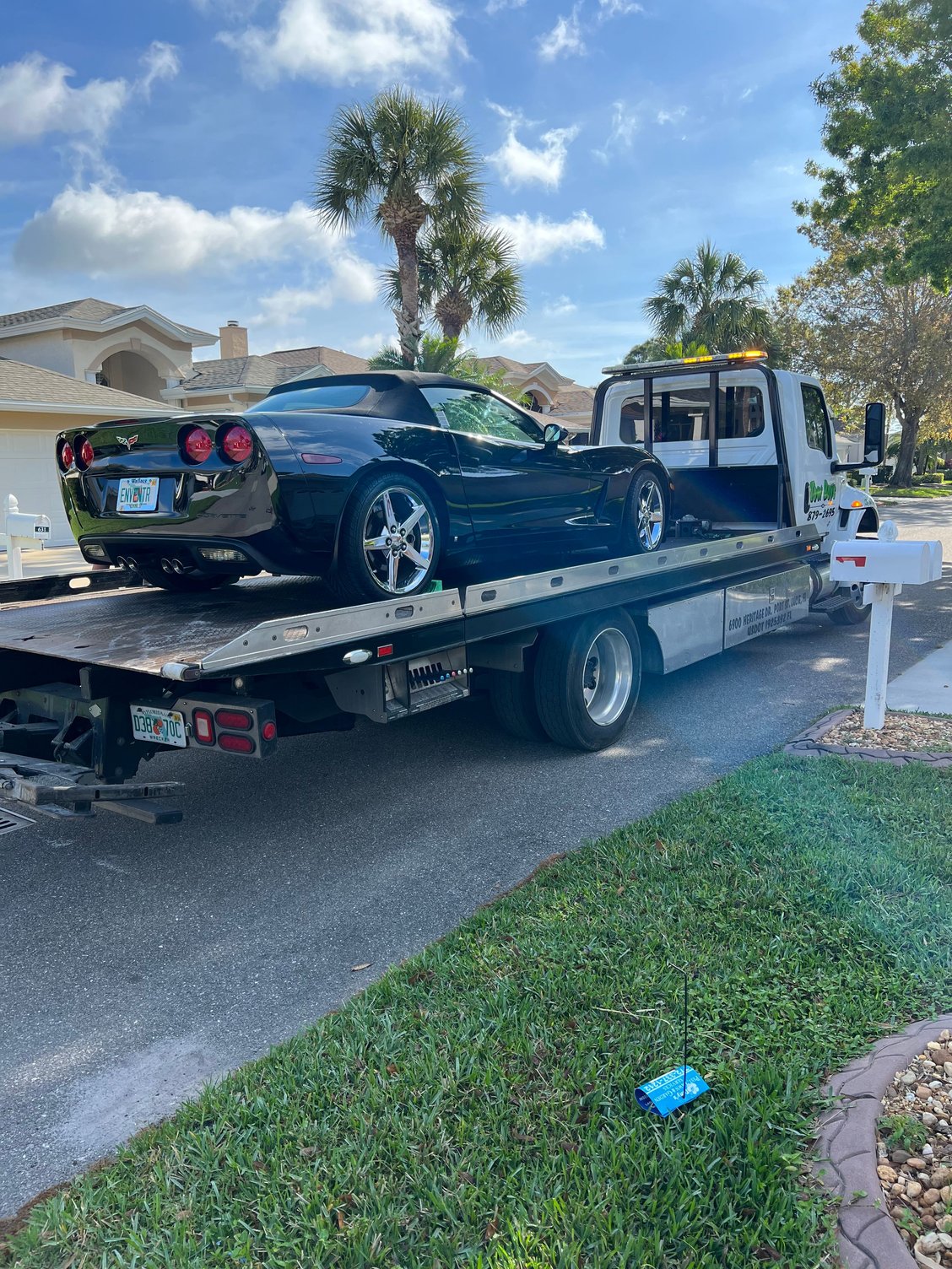

enventr's Avatar
enventr
Joined: Aug 2006
Posts: 4,147
Likes: 452
From: Port St. Lucie West Florida
On the way to the shop!
That looks all too familiar. 55K miles, although I don't think miles has anything to do with it. It's just the aging of the plastic. And in the extreme environment of the Houston area, I'm surprised it lasted this long. I had tailgate latch connections break on my 2002 Silverado twice before I sold it to my brother-in-law.
