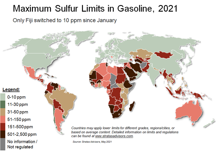

I always put in a bottle of Techron and fill the tank. Techron is supposed to clean/protect the fuel level sender. Not sure I really believe that but given the cost of replacement it's cheap insurance. I always store vehicles with a full tank to minimize condensation. Can't see how a 1/4 tank could be helpful in any way. There is very little sulfur in today's fuel in US and Canada.
