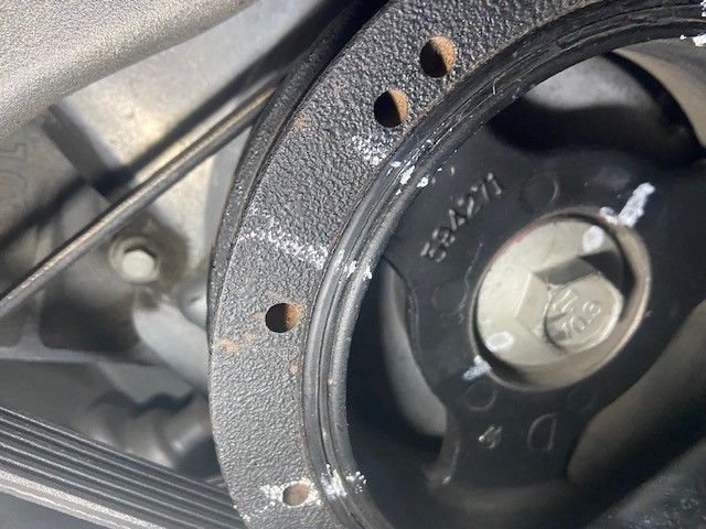

Hi guys,
I have a 2007 with 60,000KM on it and noticed a bit of a wobble.Still ok to drive or replace it? No belt chirping..its still quiet
I marked the outer and inner hubs a few weeks. back with white and the marks havent moved so far. See attached pic and video

A good general rule for this condition is to wait until you begin to experience the cold start belt chirping. Save your money for a replacement if/when that condition presents itself. My buddy has a 2007 base and we followed that wisdom before replacement at about 75k miles.
Others will tell you to do it now and avoid a possible catastrophe, I will not argue that alternate possibility, so you would need to choose.

Drive it, but keep an eye on it.

Drive it.

I agree. Mine has been like that since new. That was 65000 miles ago.
