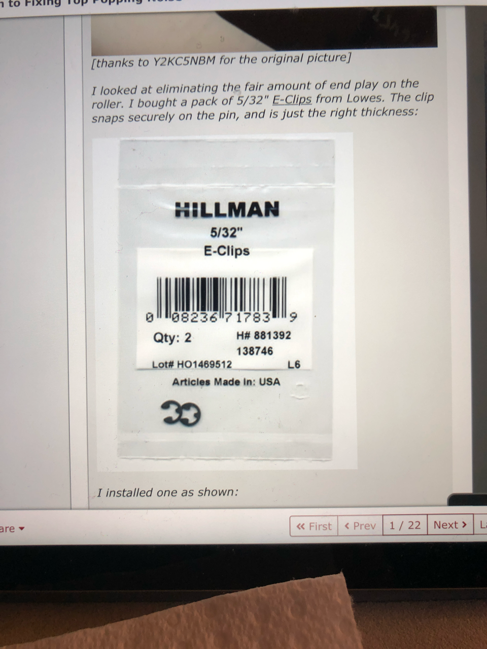

Originally Posted by Dano523
What year, since older ones had the roller hardware that you may need to C clip to the rollers to stop them rattling, make sure that the roof top peds are tight, and maybe even need to adjust the clamp.
If a z06, roof does not come off with these, and may have a roof panel that is de lam'g from the frame panel.
As for the rest, dielectric grease will stop the noise there.
Here are the clips I used to stop the noise on my roof.
One of these needs to be installed on the pin for each latch roller.
