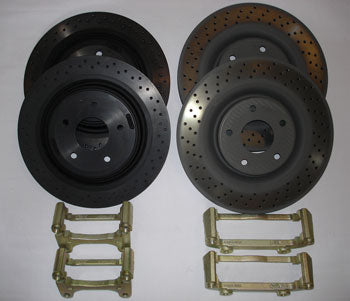

As stated, need to back it up, since we need to know if JL9 or J55 brakes to being with. Both use the same size pads, but the J55 are HD pads with higher working temp range/more aggressive pads that give better bite and pedal feed back over the JL5 pads.
Also, power bleed the brake fluid, including cycling the ABS pump and ABS valves if this has not been done for the two years. The brake fluid will absorb water out of the air (humidity) and this will cause a great deal of problems to start with (needed pedal pressure and pedal feed back to start with).
As for pads, the J55 pads have a higher working temp range over say the Bobcat 1521 pads, but the 1521 pads will have less brake dusting instead. As for initial grab/pedal feed back, its close between the two once the pads have mated in correctly.
As for pad mate in, the rotors will wear faster on the outer surfaces than inner surfaces, and depending on the mileage that the rotors have been used, may still have enough meat on them to be turned, to square both sides back up to each other. Its does not take much to square the surfaces back up, but this parallelling of the surfaces to each other has the pads matting in a lot faster, with less pad initial matting wear as well.
If the rotors are too worn to be turned, and you need to buy new rotors/have JL9 brakes in play, then easy to change out the caliper mounting brackets on the Jl9 calipers to use the larger J55 rotors instead. With the slightly larger rotors, will slightly increase better initial bite stopping power and pedal feed back as well.
