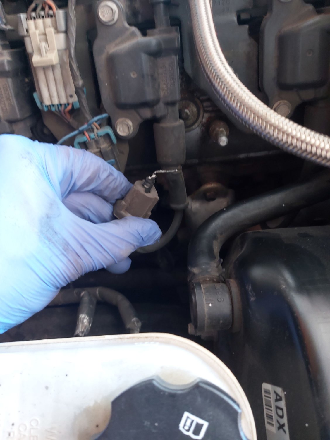

Hello,
I managed to tore 2 of my spark plug wires. Somehow they don't have those metal protecting parts. What should I replace them with?

OE plug wires..... I always change my wires for every plug change... Figure it is better to have the wires just incase of tears, Save a trip to the auto parts store. Also put some dielectric grease in the head of the boot. Helps with water intrusion and lubrication for future changes

Would guess they tear when you are pulling them off.
Likely most of the replies you get will be to replace your wires with a quality set and to lube inside the boots with some di-electric grease so they don't stick to the plugs and coils on later removals.
Multitudes of wire set choices as they are basically the same wires on all LS engines, like Silverados.
If price is a concern, I see a good set of USA made Walker Thundercore wires with good reviews available online for 22 bucks.

Thank you for your replies.
I ordered them with oem heat shields and plug wire sleeves.

OEM wires are a good choice for your application.

I have ordered some from rockauto that come with OEM heat shields.
