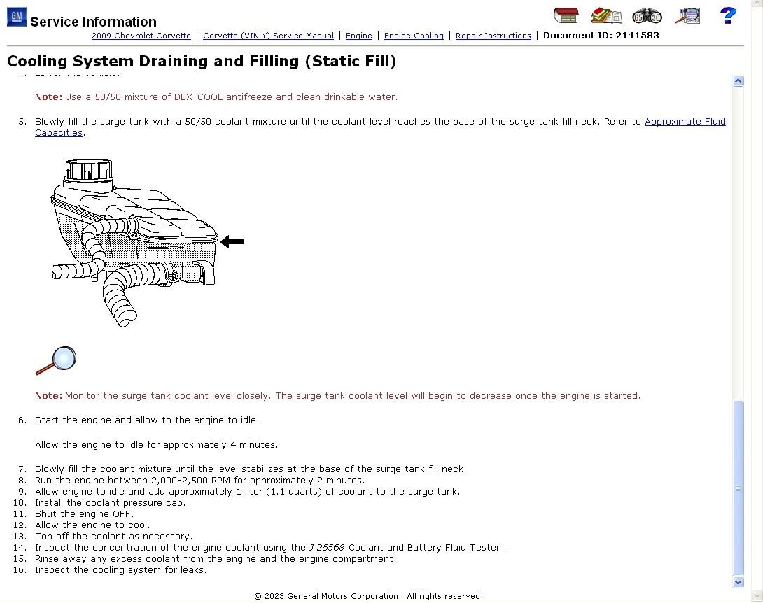

Sometimes it can be tough to get all the air out. Here's the procedure from the shop manual.
The key to getting the air out on the first try is performing fill steps 6 - 9 with the cap off.

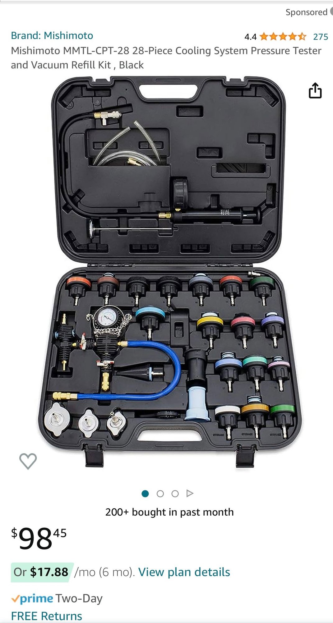

Best way to change your coolant is the “vacuum bleed” method…this is the one I use and less than $100.00 from Amazon…a little less than a Starbucks coffee.

The shop manual steps, great stuff. Thanks Jim! I was somewhat concerned when the initial fill took 1/2 gallon, and then I was a little fuzzy as to whether to start/run with the pressure cap off, but clearly the SM says to do so. Each start was quickly getting to 220 with Check Coolant Level but I think I am on the right track now as the coolant level has dropped each time, I'ved topped off, and she runs now steady at 200 or so. Rinse repeat, let cool and then final top off. Since my plan was to do this twice (8 clean qts each time) I am now armed with lessons learned and the Shop Manual, thanks again!

The vacuum pump method is the best/quickest way and is in fact the recommended procedure in the manual, but it is not necessary to get a complete cooling system fill.
That said, for less than 100bux I'm going to get one of those. Easy fill and it will also test for leaks.
