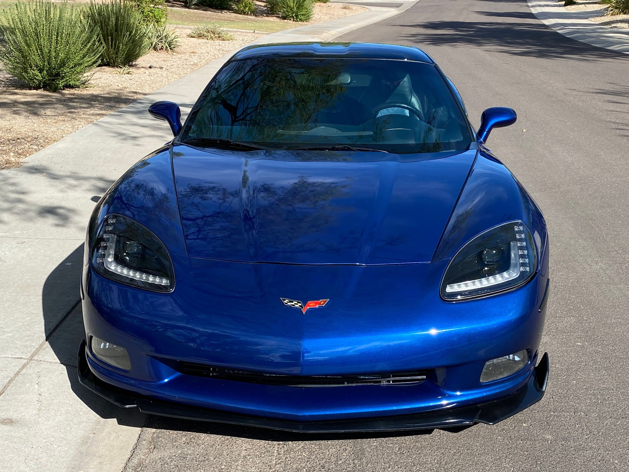

Changed my own after I first bought the car. It was a trial to get the "glue" out of the channel on one light. It was black and the other side was gray and came out very easy. I did all that work, they came out perfect, (Chinese lenses) and then after riding in a buddies car with Morimoto's, I sold the OEM lights for $400 and bought the Morimoto's and there is absolutely no comparison. The light is incredibly improved and of course the updated look is worth every penny. That's my 2 cents worth....IMHO.

Itwargssf........to quantify my statement about the brightness of the Morimoto's. You obviously can use bright lights in the OEM headlights, however, the flood of light in the Morimoto's spans a greater area than the OEMs even with the newer bulbs. I also much prefer the updated look of the Morimoto's which to me lets the front end of the car look more modern than the bug eye type look of the OEM's. Again, it's all in the eye of the beholder!

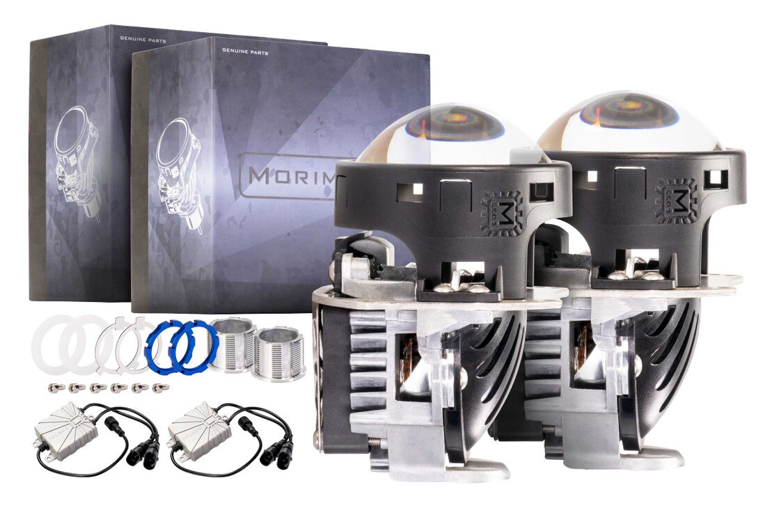

I like the moris and the c8 style but going to these guys in the stockers I think I probably have them all beat on output. Infact I'd probably put money on it... that being said, retrofitting them was no easy task.
https://www.theretrofitsource.com/bi...ED2?quantity=1

Yes the DRLs are much larger so I get what you mean by brighter. I'm going to get the Morimoto LED foglights to clean up the front but I personally love the look of the oem C6 headlights over the C7 look. That being said on different color C6s I can see the benefit. I wouldn't want paint color matched headlights other than black which is what I have.

Those must be nice, LED technology sure has come a long way but the HID wont be too far behind in a projector housing. The upgraded D1S bulb really have a nice crisp modern look and are much brighter than what they had available in 2005.
