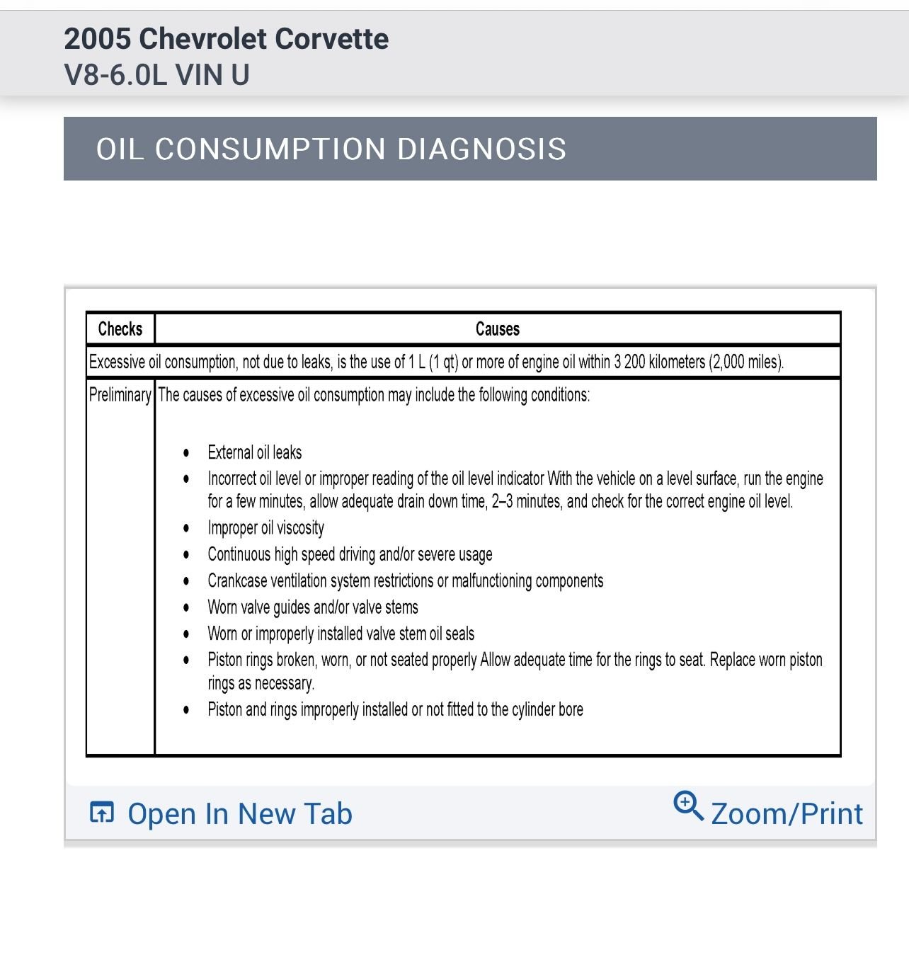

Excessive oil consumption is more than 1 quart every 2000 miles…from Service Info.
