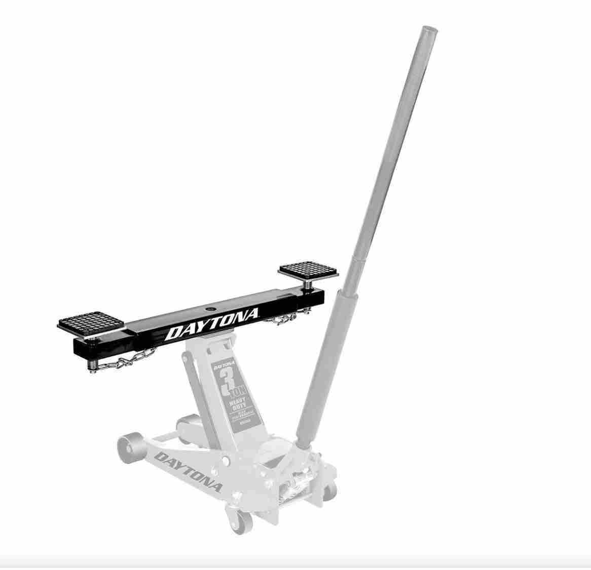

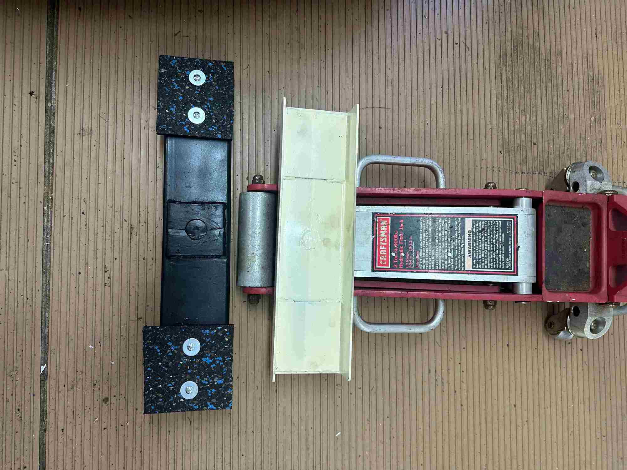

I have the pucks but honestly have never felt comfortable using them to jack-up my vette. I know, I know over kill but gotta do what I feel is the safest way to lift it. I made this so I can lift from the front or rear and have both wheels off the ground at the same time. Slide my jack stands under and It’s pretty safe to work on when you can’t use ramps. The only expensive part is the floor jack which is needed doing many vehicle projects imo. I bought most of the parts needed from Harbor Freight to make this setup. I modified the Harbor Freight cradle as it was to long and wouldn’t fit where needed under my vette. Anyway it’s not an expensive project is you already have a floor jack in most cases. I think the cradle from Harbor Freight is about 70 and it’s SUPER HEAVY Duty... and excellent for the price imo.

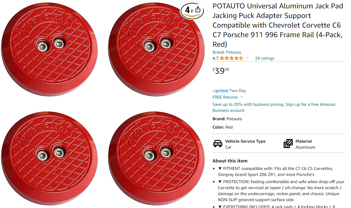

I went with these off Amazon. They do the job by just extending lower than your bodywork and they're easy to see. I wanted to leave them mounted in case I ever rolled into a tire shop or had to get jacked up somewhere by someone else. These give them a target. There's a lot of varieties of this style online.

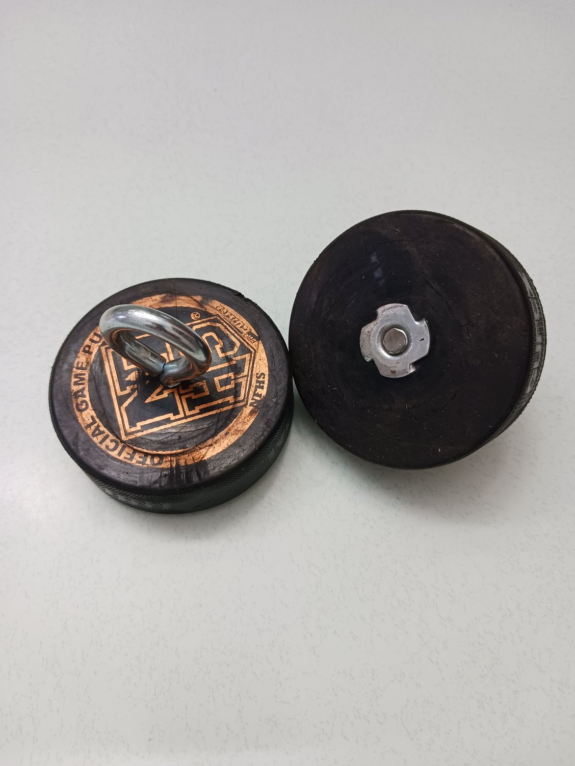

You can always make your own pucks.

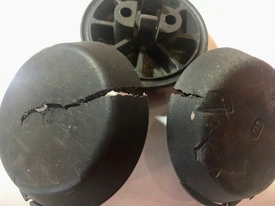

I would not buy these again.

What happened? Is this from usage or hitting speed bumps?

Over 17 years, just by using my floor jack.
