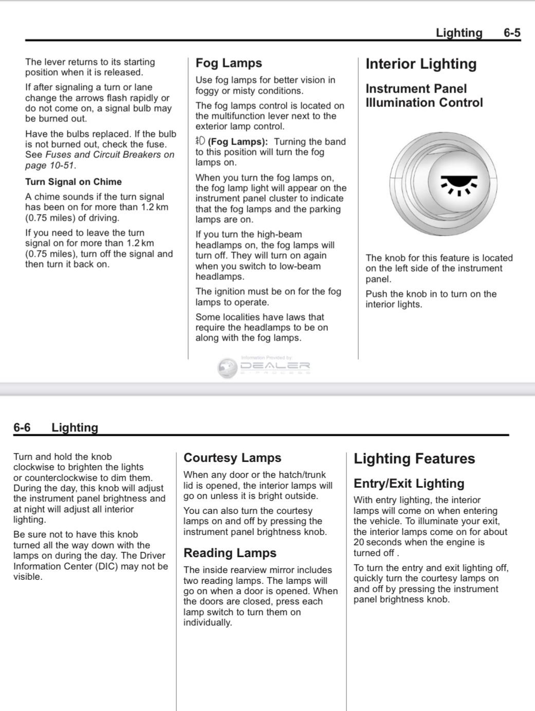

I'm pretty sure I have some extra functioning pod buttons. If you can wait until next weekend I'll be home so I can check.
I'm assuming you turned the dial on the gauge cluster surround to make sure the brightness was turned up.
Thanks Jab.
The dash lights are bright so I assumed the pod lights would be in sync.
Now you’ve got me wondering if the pod lights would turn on separately from the dash lights.
it is odd that all the buttons are not lit.
Will check later and report back.

All good Jab - checked in a pitch black garage and lo and behold, the pod lights do come on.
Arguably they are not the brightest.
I think what threw me off is that while you can see the dash lights in the daytime, you can't see the pod lights.
They're on - you just can't see them illuminated.

Yep that's normal.
