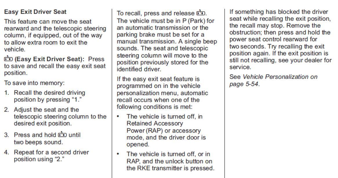

how do you store the easy exit option?
Old Oct 16, 2023 | 05:45 PM
MKenM's Avatar
MKenM
Joined: Jul 2011
Posts: 2,780
Likes: 314
From: Morris Co. NJ
St. Jude Donor '12-'13-'14-'15-'16-'17-'18,'21
See below:

^^^This will work.
