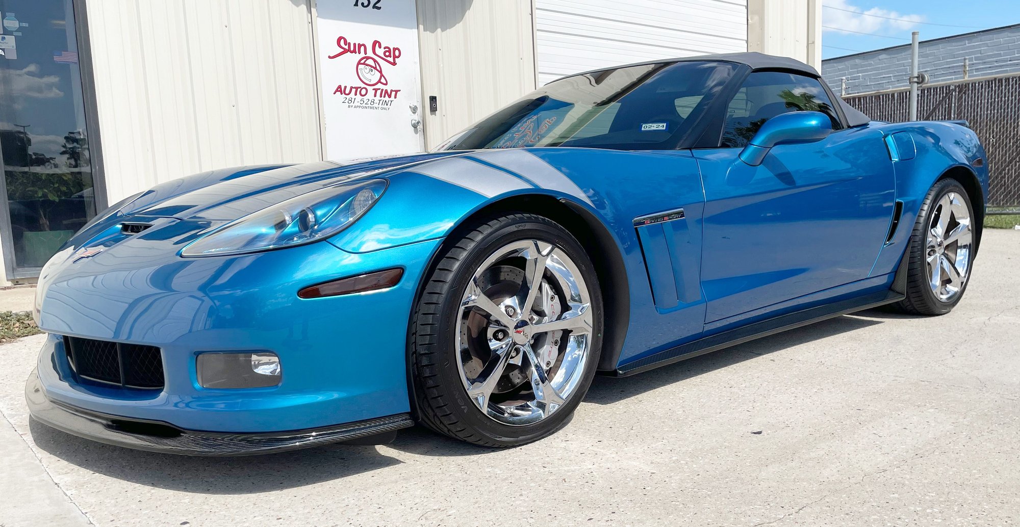

Recently, I had my tinter install tint film over the side markers so it could be removed if necessary, and I had the same thing done to my 2008 Z06 many years ago. Not sure if my ZR1 was tint film or not because I bought it with the side markers already tinted. My inspector said that as long as he could see the lights during the day when illuminated, he wouldn't fail it. Fingers crossed that the laws haven't changed in the last couple of years.

I just picked up the car, and fortunately he was aware of the "reflector" status, so they are only lightly smoked and still have visible amber and red showing through in the daylight. Of course, my iPhone didn't pick that up, but you can see it with the naked eye.

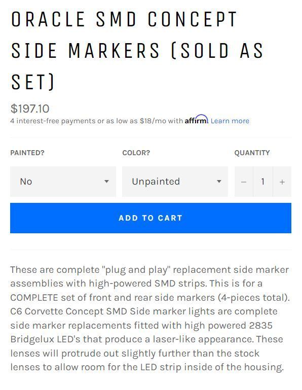

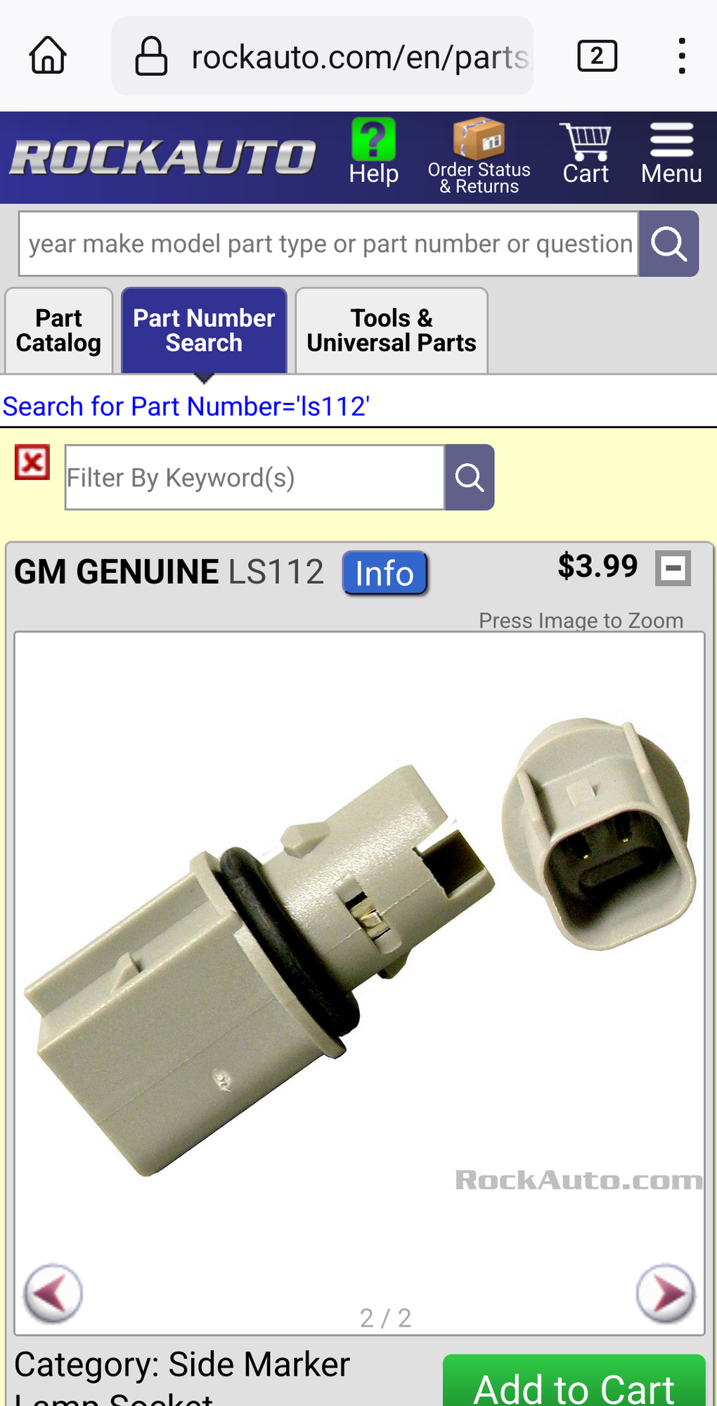

The Oracle side markers my car came with with did not have the oem sockets. I bought Vette Lights sidemarkers and had to buy the sockets. Ordered from RockAuto:

I'll assume you're generally curious. I just watched a video on Youtube to make sure what I said was accurate. The OEM light is removed complete with socket and bulb. The Oracle light has a socket built in that connects directly to the OEM pigtail. Still plug and play but without that socket. Maybe there is a newer version. My Oracles were old enough to be coming apart, which is why I replaced them. And the video is from 2018. But the Oracles on my car definitely didn't have the sockets, which the VetteLights needed. Regardless, the question was where to buy the sockets. I assume he would know if he needed them.
