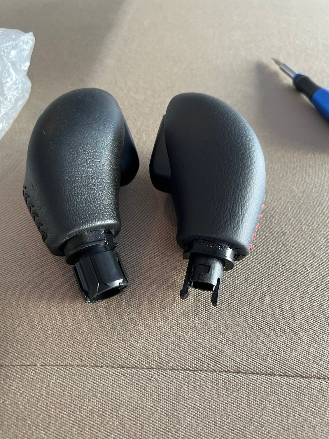

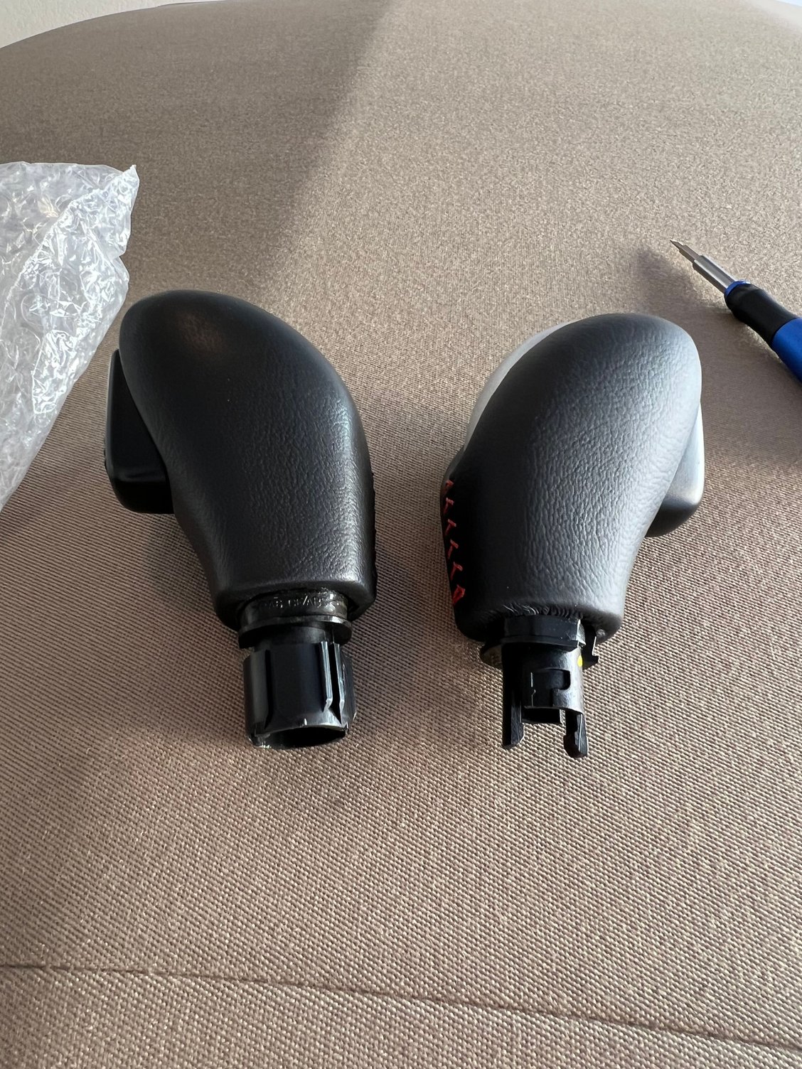

My shift **** is a bit worn and the plastic top piece broke so I got a new shift **** to put in.
When I removed my old **** there was a plastic piece on the end of the **** that isn’t there on my new ****, it also looks like there is a plastic piece in the boot which this piece fits into
Picture of my new **** which doesn’t have the piece that fits into the sleeve in the boot.
do I remove the piece from my old ****? If so how? I bloodied my fingers trying to remove it from the old **** and couldn’t figure it out. Hopefully this make sense. A bit frustrated at the moment.
can anyone shed some light. Thanks

I’m trying to get the bottom piece off the **** on the left but I can’t figure out how it comes off?

If my memory serves me, you have to pull down on the top trim ring, immediately under the leather, and twist the **** to the 1 o'clock position and pull up.
I just found a PDF that explains it.
