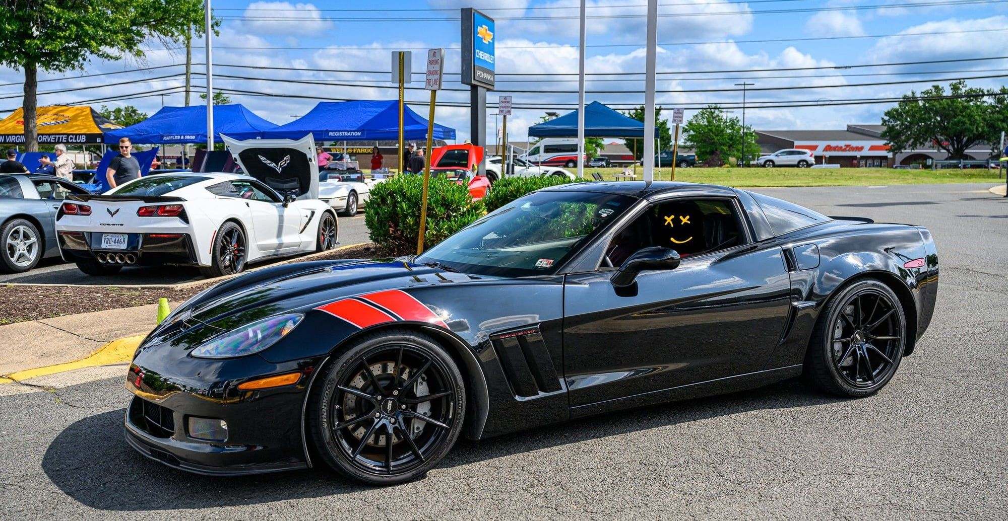

Old Nov 26, 2023 | 11:56 PM
C6_Prodigy's Avatar
C6_Prodigy
Joined: Sep 2022
Posts: 851
Likes: 390
Originally Posted by 2010vettegs
Any pics you can share?
Basically just this one. The 19" front does make the front brake look a little smaller in my opinion.
Agreed. Personally I think that sports cars tend to look better with the smallest wheel that clears their brakes.
