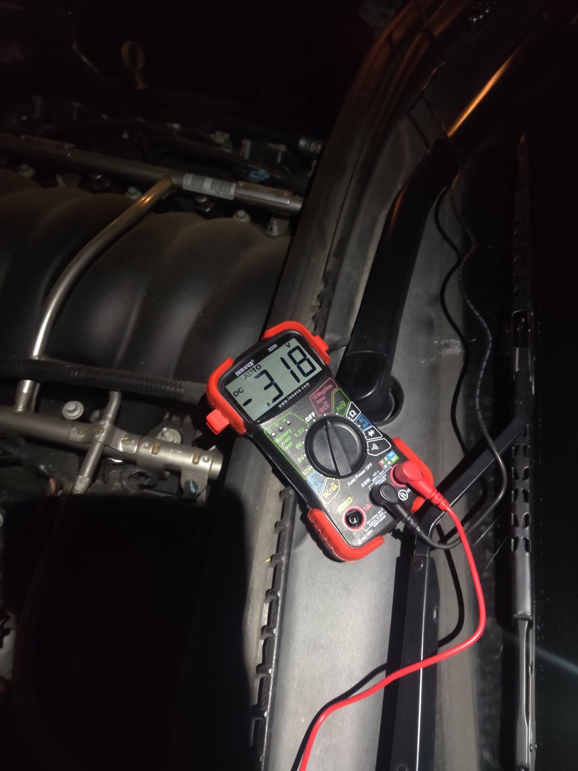

I went ahead and I tried the flush and I really cleaned up the 4 major grounding points I could access in the engine bay to no avail; same issue. I did do more research into grounding the radiator and discovered that it would be a bad idea. This time when I ran the multimeter test I let it idle for longer. It seems the lights really contribute to the problem as well as run time. I let the car idle for about 10 minutes and I was reading about .318 volts. Only the headlights, high beams, and horn seem to affect the voltage increase/decrease. I tested turning on and off the ac and stereo, as well as the brake lights and they didn't seem to exacerbate the issue. The voltage didn't increase with raising the rpm. Anymore ideas? This issue is stressing me out because this is currently my only transportation and if it's eating my aluminum radiator it might be working on my engine block.

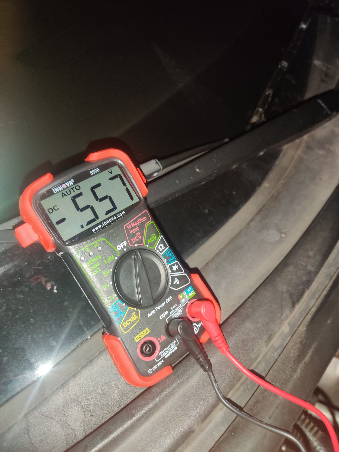

Interesting enough, so I read from engine to ground (using the bolt on the engine that the manual says to use for jumpstart) and I got a reading of 1.1mV which seems okay but not quite 0. However I tried testing some resistances which give give a good explanation of what might be going on. I tested from the engine to ground and got a resistance of 6.6 ohms. I tested from my radiator to ground and got a resistance of 0.0 ohms. Therefore my radiator is a better path to ground than my engine grounding points. Can anyone else confirm this is not normal on their c6? If that's the case how can I improve the engines grounding points and add more resistance to my radiator? (Additional note after I turned off the car I checked the voltage from radiator to ground and got this lovely number)
I guess my coolant is holding a charge.
