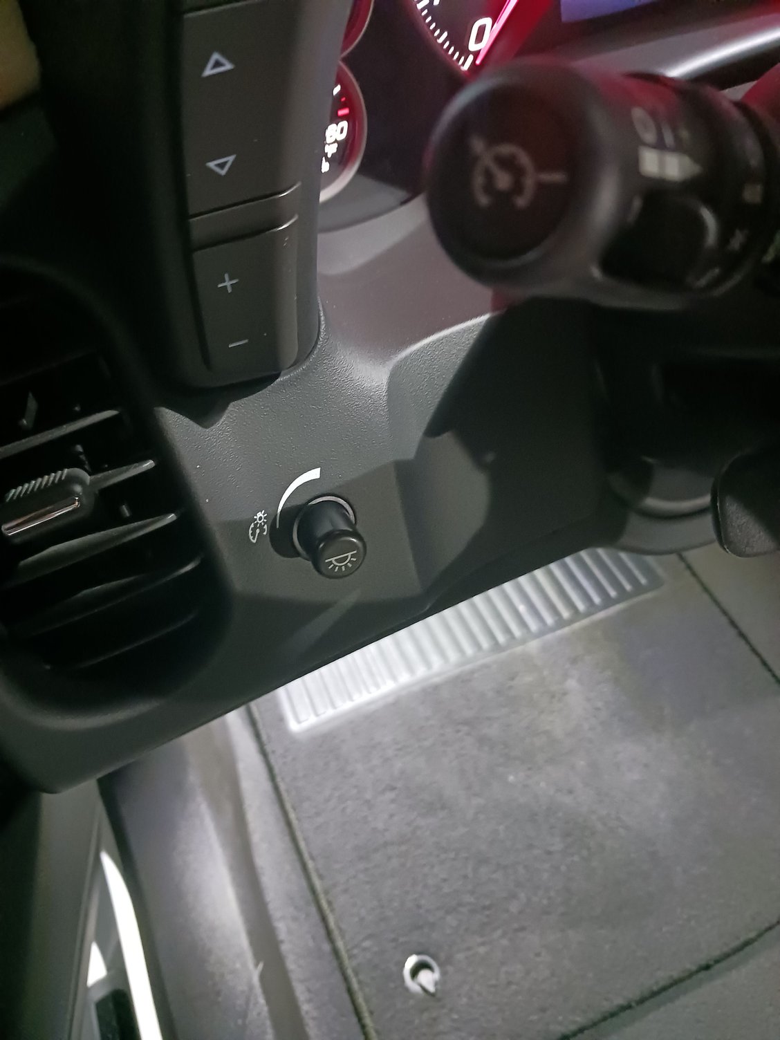

Are your foot well lights working?
it's possible you hit the dash light switch with your knee

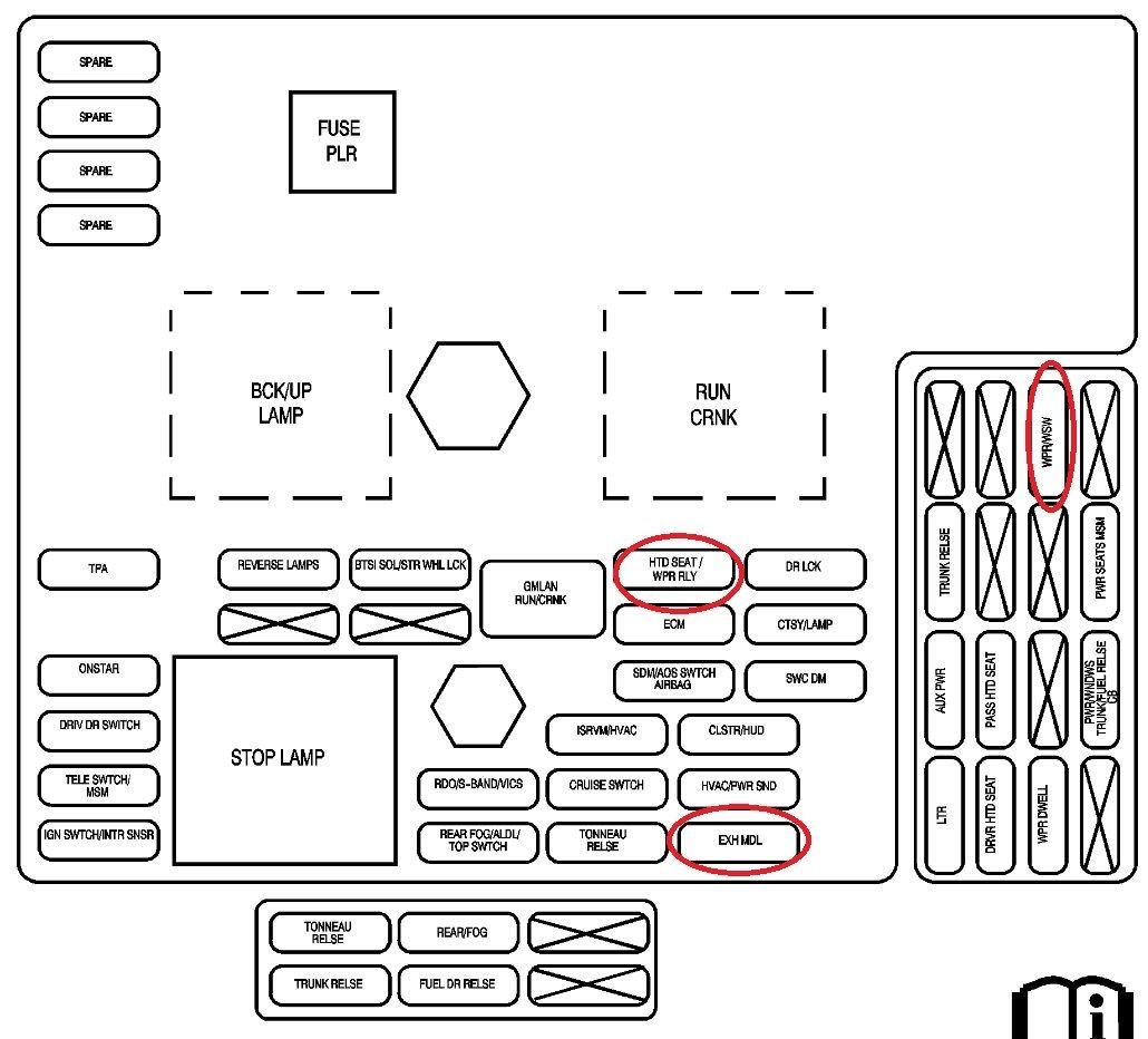

To answer the question, yes, the bulbs can burn out, even LEDs, as I found out. But both at the same time is unlikely. If it’s not the classic dimmer **** problem, and if the other interior lights aren’t working check the fuse panel in the passenger footwell at the location CTSY/LAMP.
