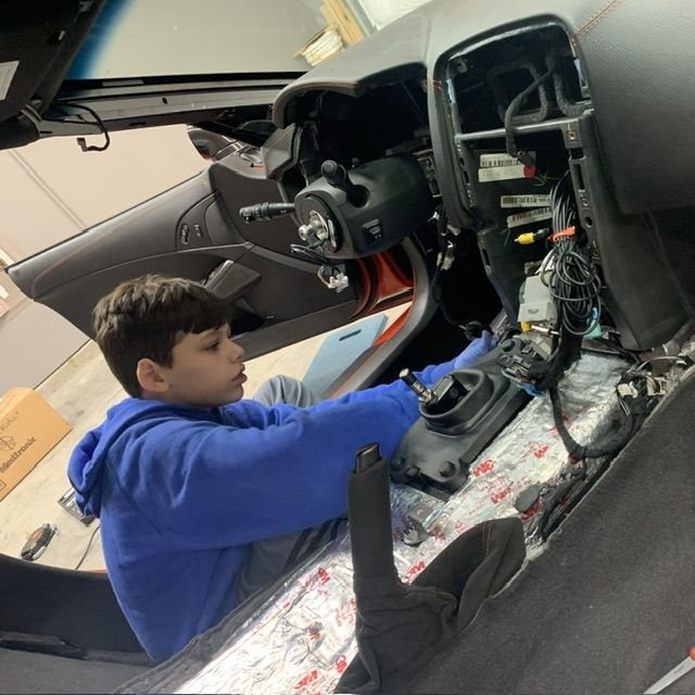

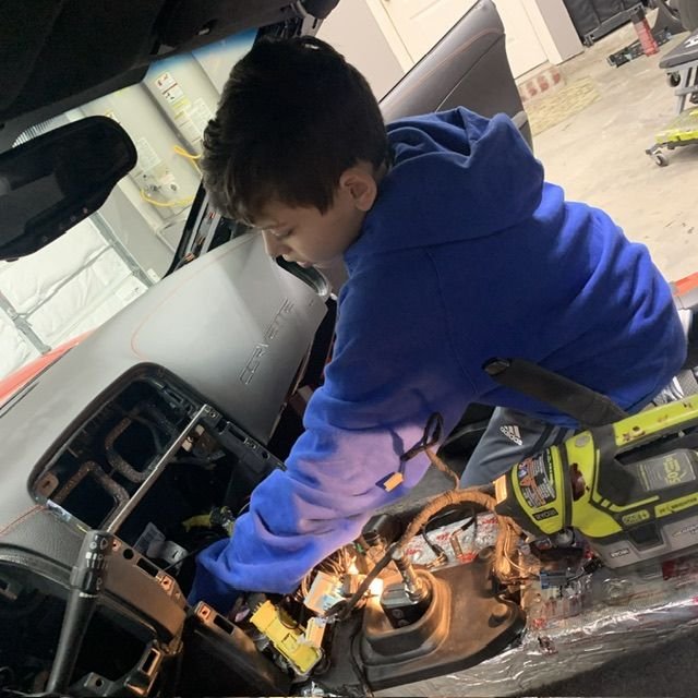

How awful can it be? According to this https://www.corvetteforum.com/forums...post1606150563 all you need is the help of a 10 yr old, and you can R&R the dash in 3 1/2 hours

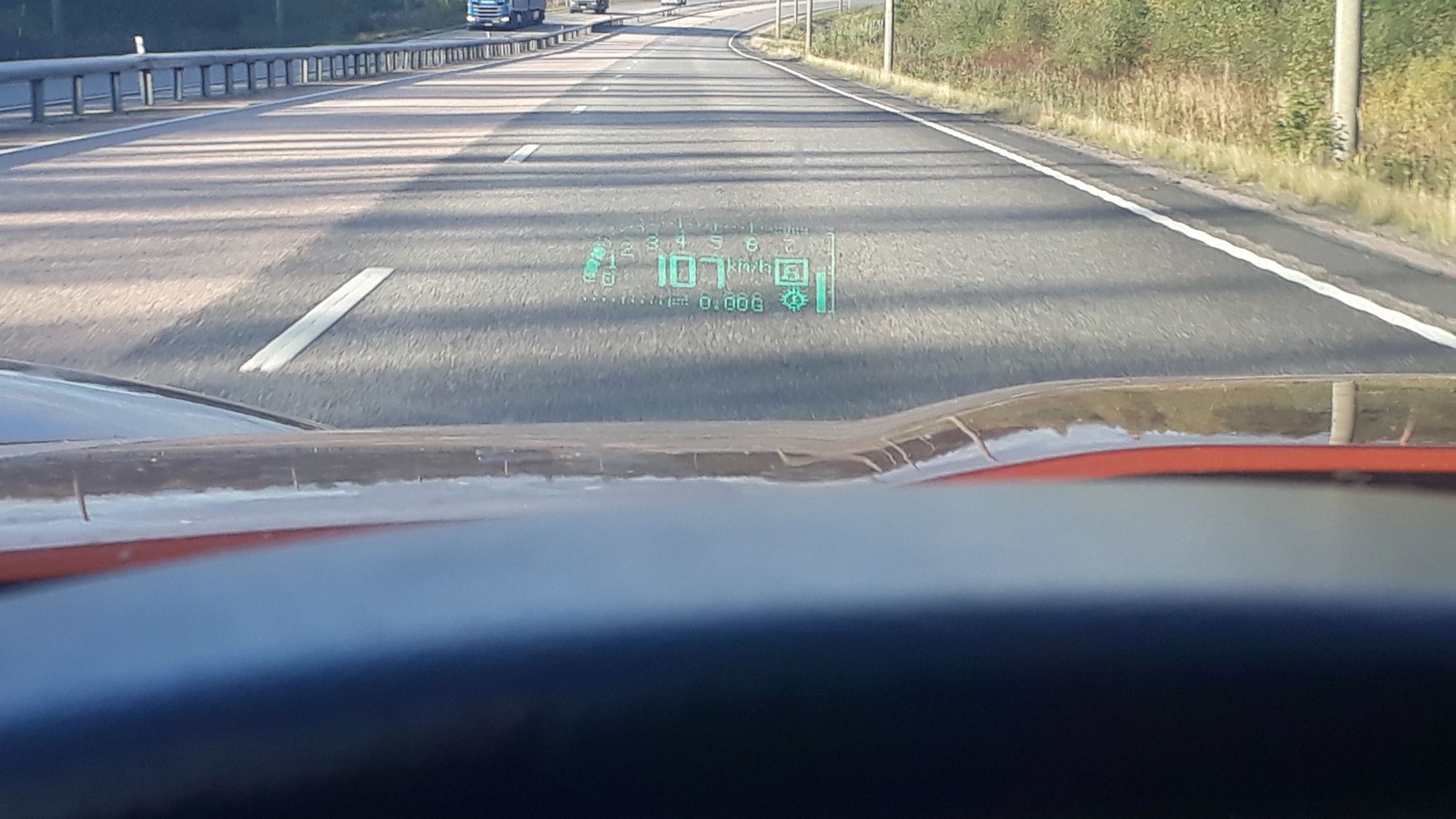

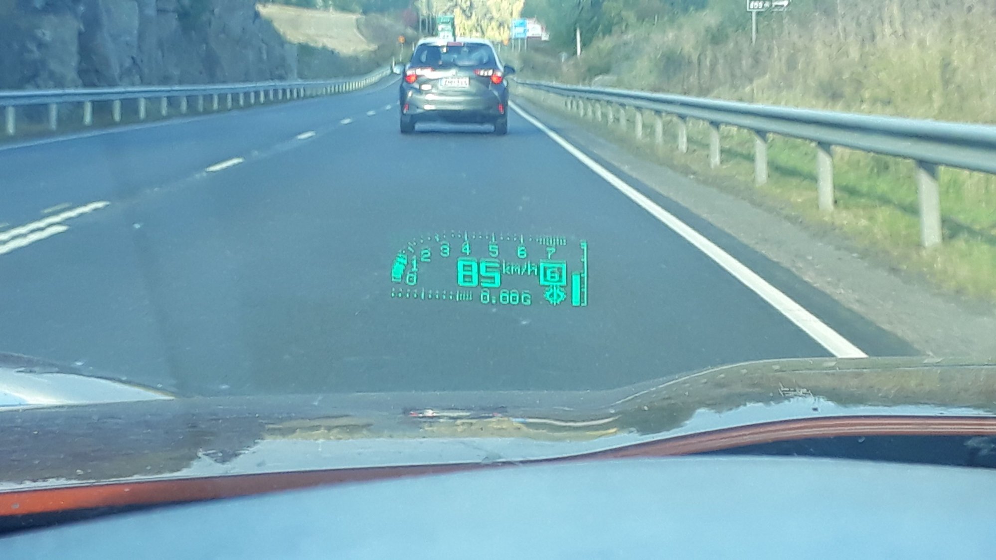

Originally Posted by TCW
Key word here is "almost"!
Well, here's some evidence, although taken with cell with one hand, so they are a bit out of focus:

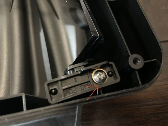

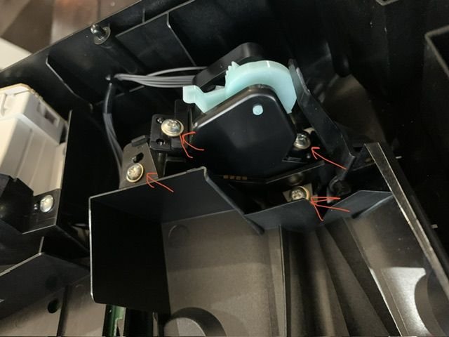

That's true. While my dash was out I also disassembled the HUD projector and added washers to all the screws inside for the mirror assembly so that I don't have a failure down the road.
I also installed the HUD projector into my '12 GS 1LT using the "cut the duct" method. I think R&R the dash was easier. That being said, I don't think it's worth it to add it to a C6.
