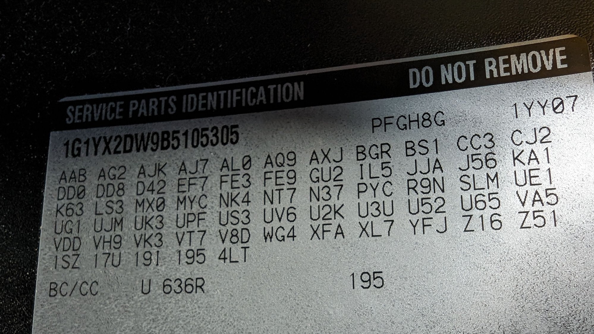

Can someone please explain code WG4 Grand Sport Conversion? Vin says Grand Sport 2LT but code 1YY67 says base convertible. Thank you

1YG67 = Grand Sport Corvette Convertible
EDIT: Actually, my RPO sticker also says 1YY67. Interesting.
What is the complete VIN? My bet is it's a real Grand Sport. Look for Z16 and Z51 in there.
Incidentally, here is a real 2011 Grand Sport convertible (i.e. mine):
your RPO codes also have 1YY67 = base convertible and WG4 = conversion. Same as mine. That was my question. GS should be 1YG67.
My guess is they all begin life as a base, and then the options are added in the factory. WG4 takes it from a base convertible to a wide-body Grand Sport, and then they add Z16 and Z51 performance options. The RPO sticker is specifically for service parts ordering, everything else (chassis, interior, etc.) it's the same as a base model.. Z06 and ZR1 have aluminum chassis and more carbon fiber bits.

Our cars are almost brothers! Mine is also a 4lt Grand Sport. Look at how close the serial numbers are.
Well, if you're talking about mine, you're missing about 9 RPO codes, yours is an automatic, and it's Blade Silver.

I think there were only about 350 4LT's for 2011, and the serial numbers were less than 2000 apart.
Edit - I was wrong 385 Coupes were 4LT and 513 Convertibles were 4LT. I thought total % of 4LT was about 2-3%, I guess it's more than double that. Not as close as I thought.
