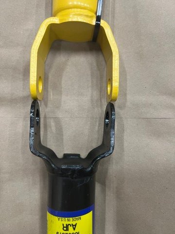

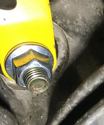

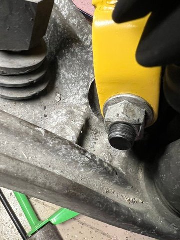

Originally Posted by Dano523
The DRM's, are B8's with slightly stiffer dampening, so will hold the car lever in the corners a little better than the standard B8's.
As the kicker, the DRM's can be ordered with poly bushings, and coupled with changing the sway bushings out to poly as well, world of difference just there.
I recently installed the DRM's with poly bushings on my '08 w/ Z51. Unfortunately, I haven't had it out yet to feel the difference. My intent is for better performance for HPDE days. I got them from Doug Rippie Motorsports, the total for shocks & poly bushings was about $600.
If you go this route, you may run into an issue I had. The OEM lower rear mounting bolt was too short to get the nut fully threaded & lock as designed. This is due to the Bilstein's having thicker "ears" at the mounting point. I replaced them with longer bolts (M16-2.0 x 110 mm) from a local hardware supplier Tacoma Screw or you can get them online from McMaster-Carr.
Bilstein is thicker.
OEM Bolt Length.
Longer M16x2.0x110mm bolt.
OEM Bolt Length.
Good tip.
I also replaced my bolts and locknuts, got them from McMaster-Carr.
