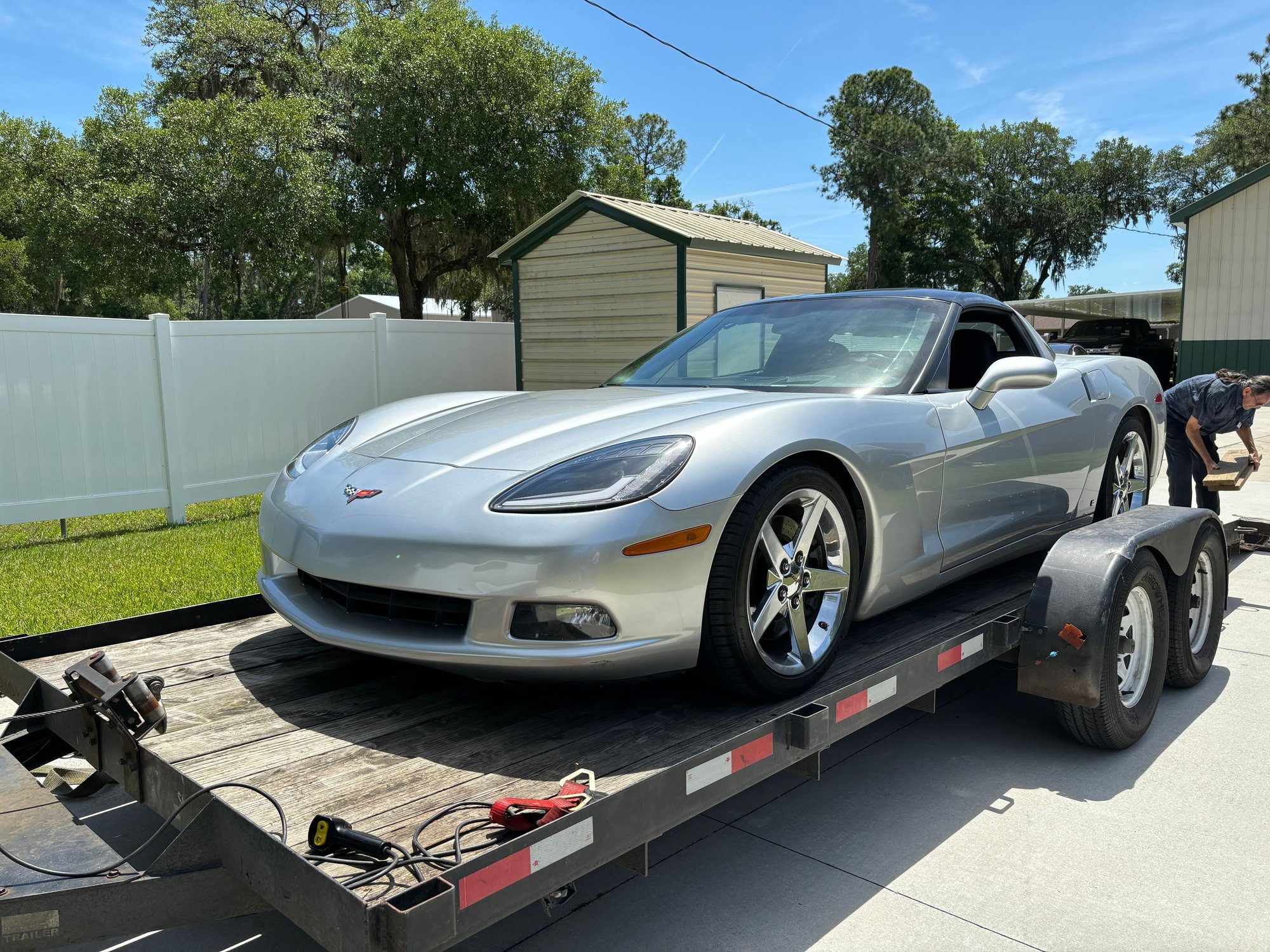

She’s home!! Absolutely love this car already. It started up for me first try when I went to go buy it. After being trailered home, it took three tries to start and it sounds like the starter was not disengaging.

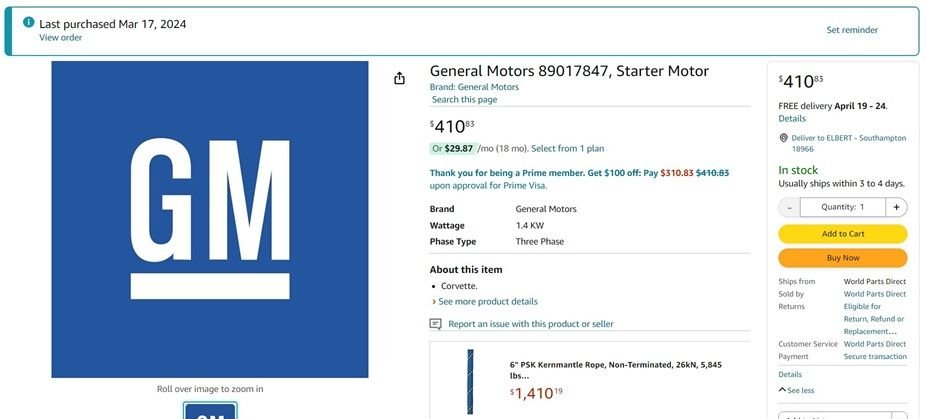

I just bought a 2009 Chevrolet Corvette, 1 owner, 24K miles, the car is in excellent condition, will keep it for many years.
Have been buying new replacement parts before they are discontinued, Starter, Alternator, Water pump, Brake Pads and more.
Buying parts from NewGMParts, Amazon, eBay, GM parts only seems to have rebuild starters, found a new starter on Amazon, shipped by Classic Chevrolet Sugarland.
