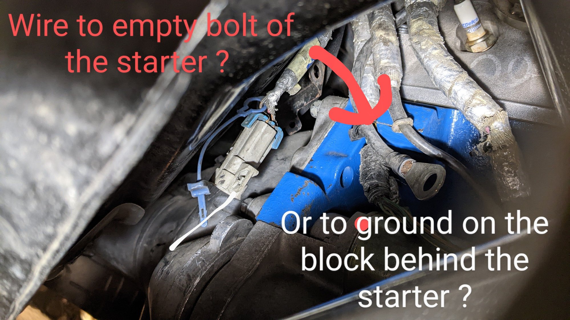

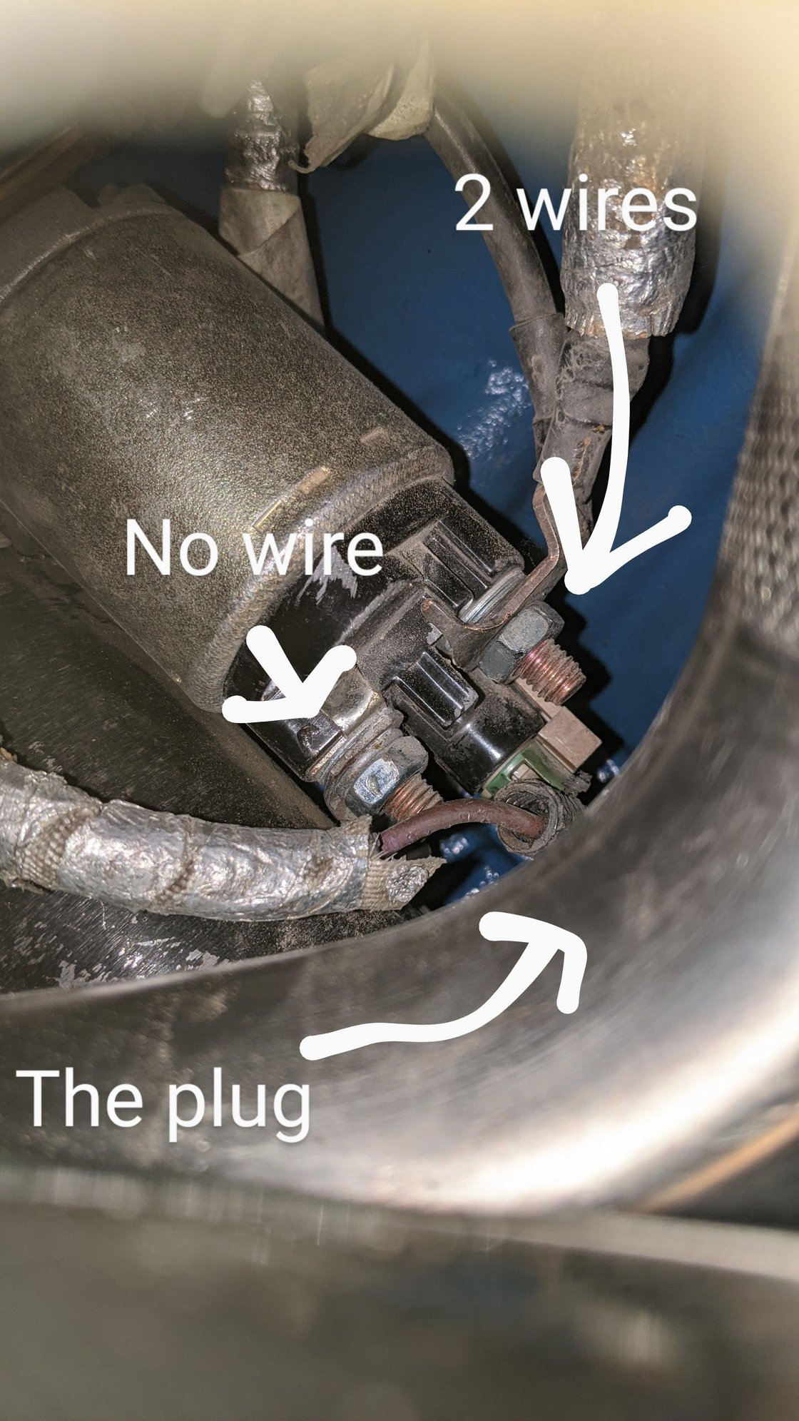

Hi,
on a 2008 C6 MN6 bought w/o engine,
i finished to build engine and install it,
I'm pluging everything now,
But issue on wiring and metal sheet on clutch bell
*** 1st, the large wire... ***
2 wires was link on the top bolt, so, seems to be good
​​​​​​i put the special plug
but the other bold (down) is empty, it's good or do the black large wire have to be on ?
in other case, do this black large wire have to be on thé ground blow under the starter ?
(On other words, where bolt this wire ?)

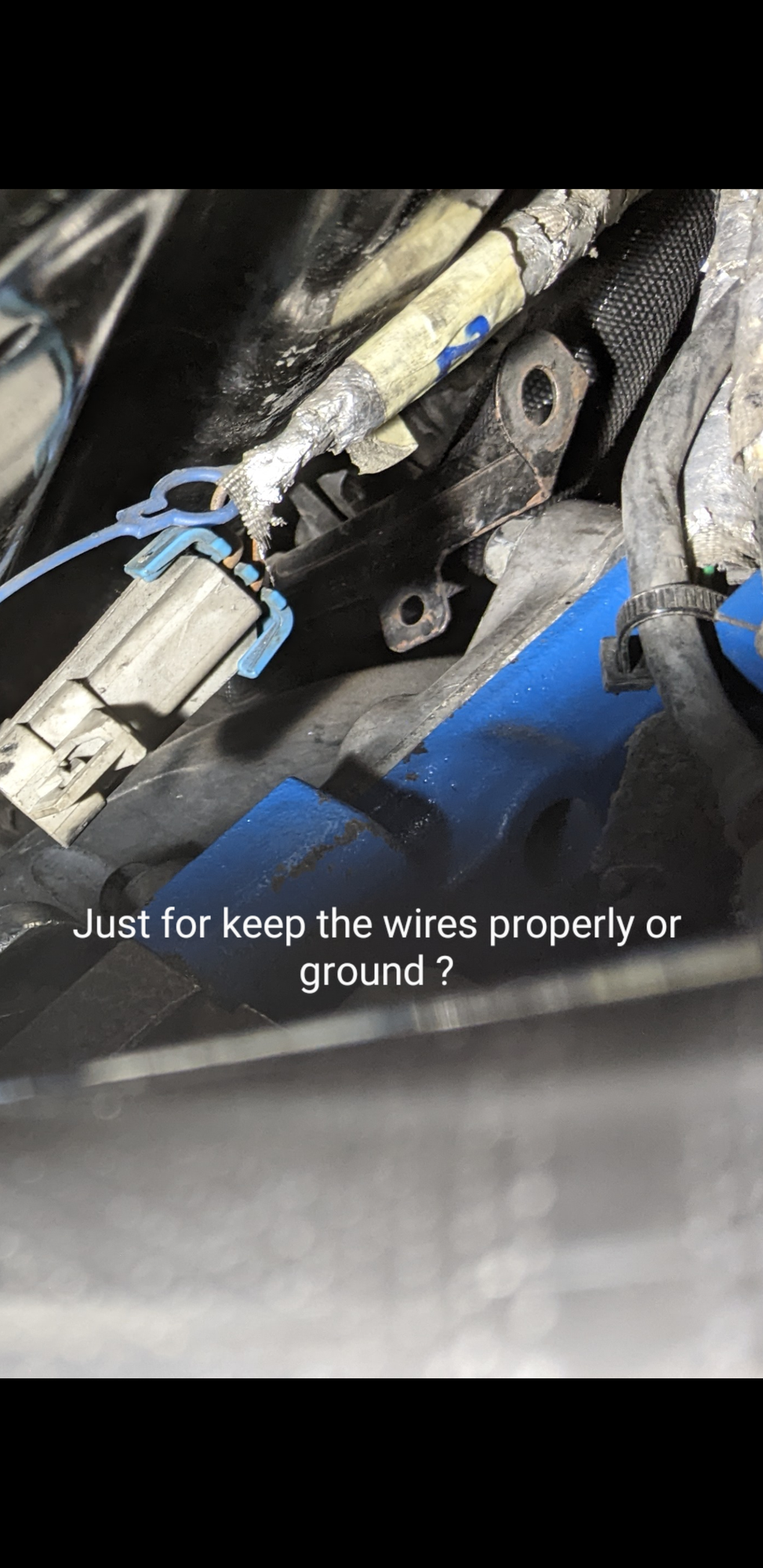

*** The metal sheet on the clutch bell ***
As i installed the engine with the clutch bell on, i forgot to bolt on this metal sheet,
Do the bolt is only for keep the wires properly attached, or do it's using for ground ?
​​​​​(On other words, do i need to bolt it or can i stay like that ?)

No wire is good, since its the wire to the starter motor already in play already on the down side of the solenoid
The two wires, should be the positive from the battery, and the cable from the alternator on the bottom of the two.
Yes on plug, from stater relay wire in engine fuse box.
Wire keeper that will go on the starter motor mounting bolt.
