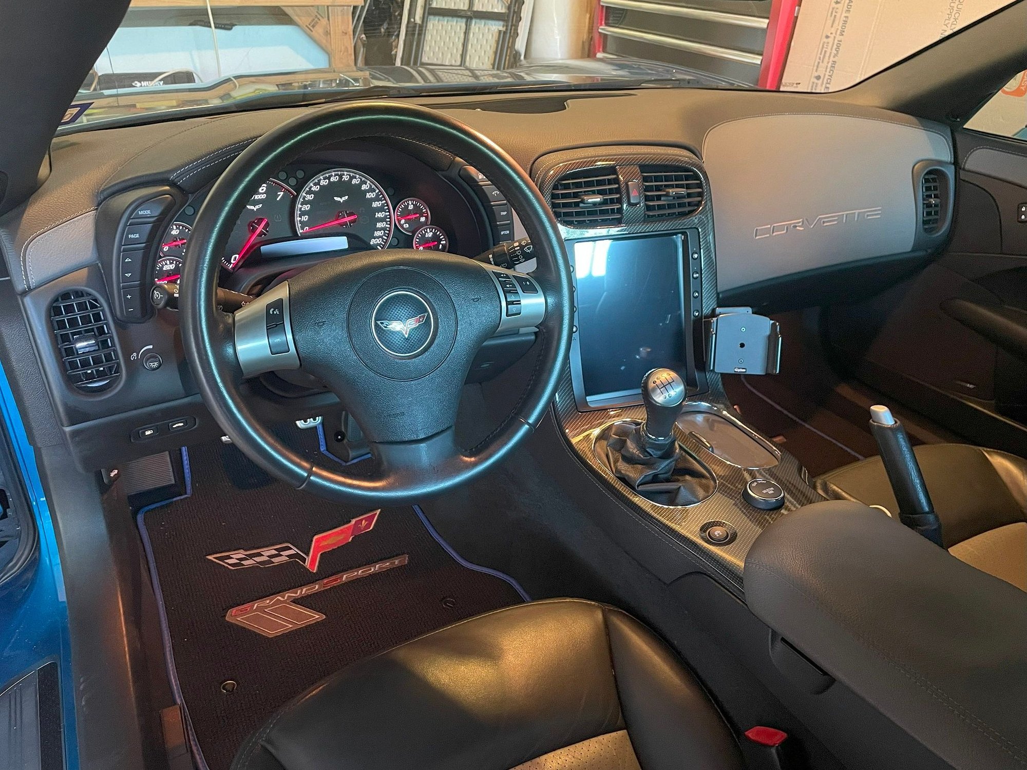

It really depends on how you take care of the car. My ZR1 had some very minor bubbles in the dash because before I bought the car it spent most of its time at car shows, and this Texas heat can wreak havoc on them. My Grand Sport, on the other hand, never saw a car show, but it had 36K miles on it when I bought it from the original owner in 2022, and the dash is near perfect except from some very minor separation down by the windshield. Whenever I park it, I always have a heat reflecting sun shade, so that helps. Otherwise, it lives in the garage.
Be very careful about what you use to clean it also.
Here's my dash. 39K miles and 13 years with it still looking pretty good:

Mine also first started letting loose at the front edge. It took a couple of years before it started creeping up further, then slowly started bubbling/letting loose all over the whole dash. After maybe 5 years it started rapidly letting loose all over, which is when I'd had enough and fixed it. I hope it doesn't, but I suspect yours will follow the same course. I've owned my car for 10 years now.
