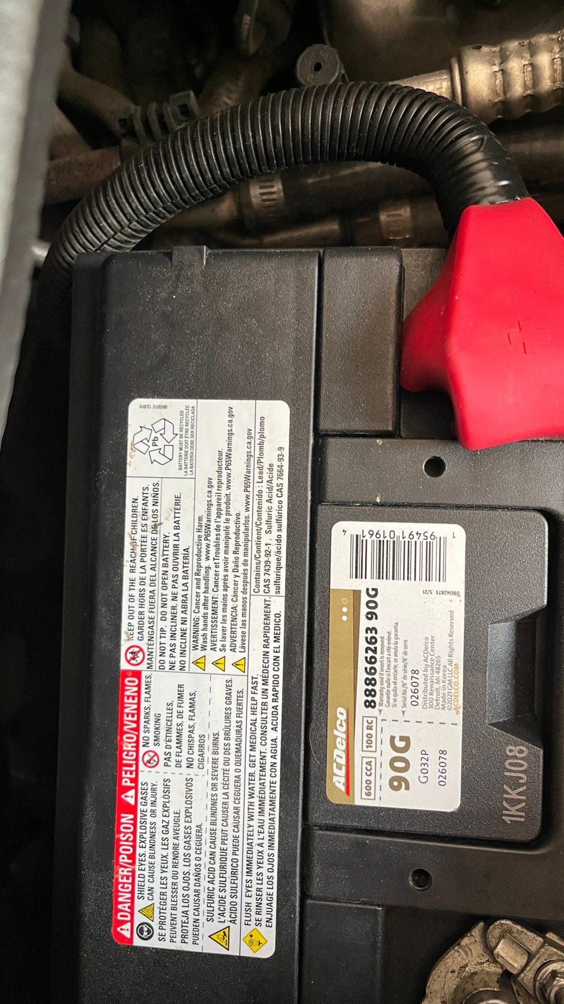

I can tell you for a fact that an ACDelco 88866263 fits perfectly in my ‘11 GS A6. Group 90. 42 month warranty. I put it in there myself. Can’t see any reason why it wouldn’t fit in your GS.

Looks like AC Delco Group size 90.
