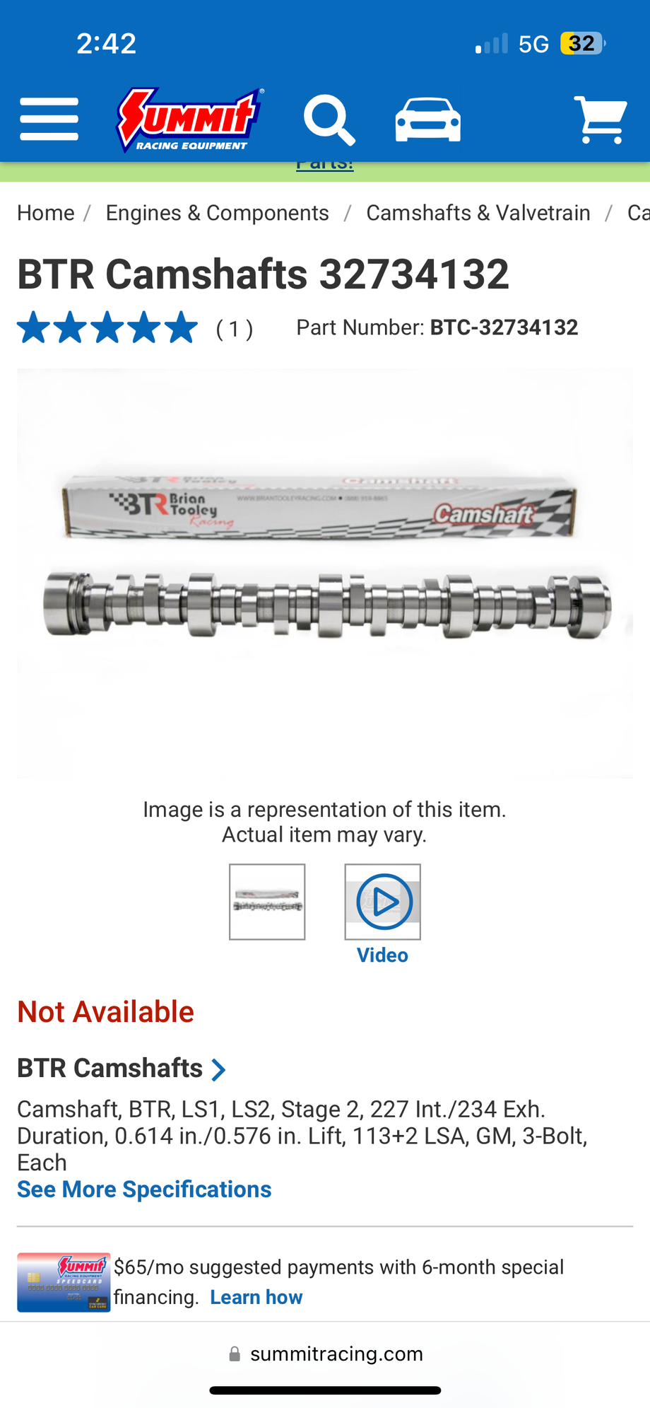

could you please share where you got your hands on the cam? I noticed BTR stopped selling ls2 cams

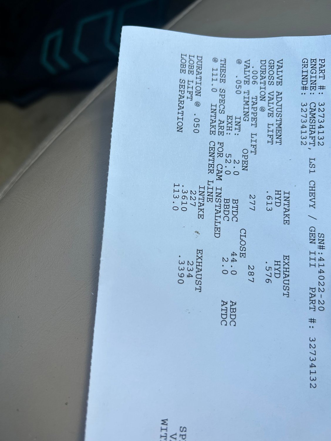

Originally Posted by StayinStock
Lifters should be a must although alot of people dont. The stock GM lifters dont play nice with the 660 springs. I'd recommend going to a Johnson short travel. Also all the obvious cam stuff (springs, valve seals, retainers, ect.) Trunion upgrade should be considered while your there. The key is stabilize the valvetrain. Pushrods will depend on preload of the lifter so order those last so you can measure for them properly. All that aside may as well throw a good balancer on it since you have to take it off anyway.
This is the cam I’m going with.
I’ve had these sitting for a little bit but if you search my exact ones it recommends another cam kit that should work on ls2.
No real such thing as an LS2 cam. LS1 LS2 LS3 LS6 use the same cams in the aftermarket.
