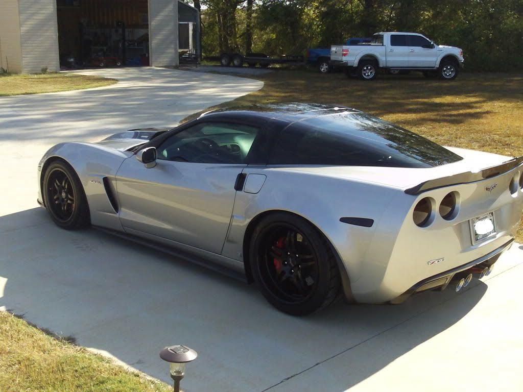

Can you post a full image of your car and what type of wheel?
If they are aftermarket wheels, I wonder what the back spacing is?

I would like to do this look, just I believe these were 10s and 13s mine are 10 and 12
