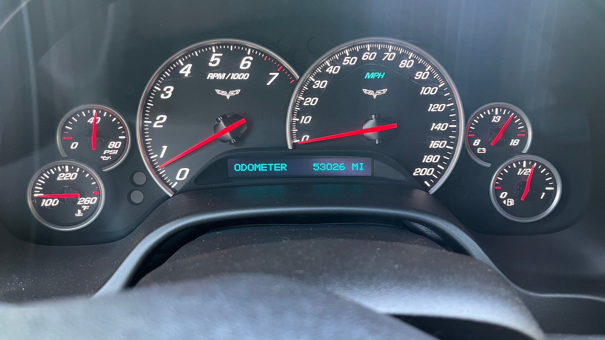

Originally Posted by PMPerformance
is it always 80+* where you live?
In Toronto? Hardly. As it happens, here is a pic from right after I started the car the other day. Ambients were around 65° IIRC at that point. And I’ve started it a few times at 40° and no difference.
