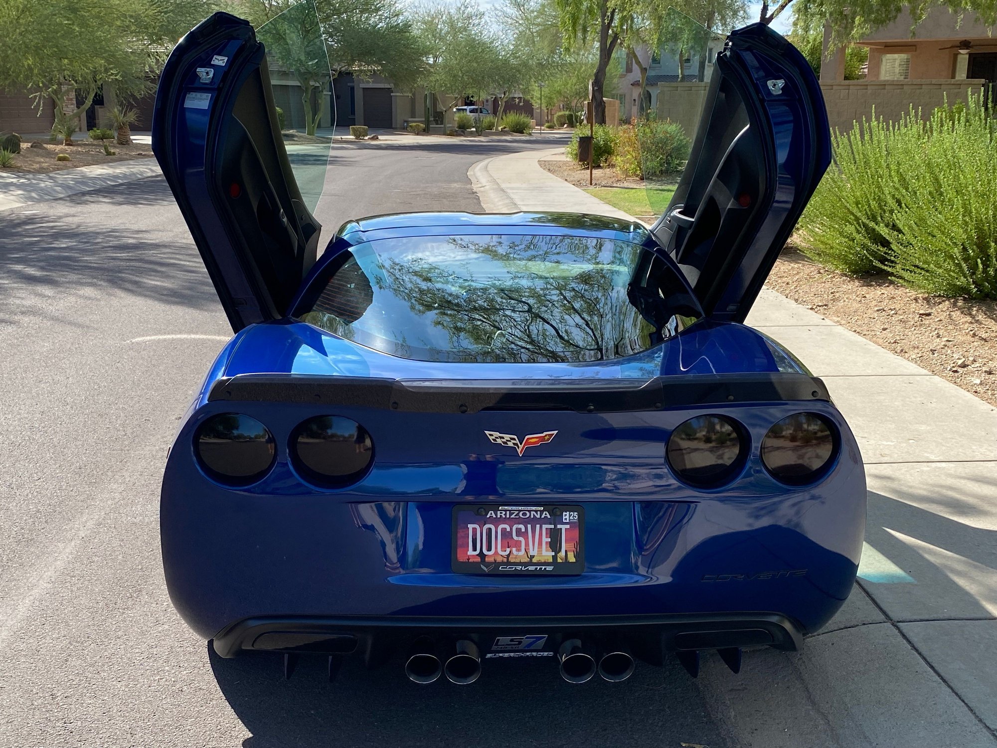

I bought everything from Vette Lights and I did not have to add any resistors and I replaced every light or assembly I could on the outside and Inside.

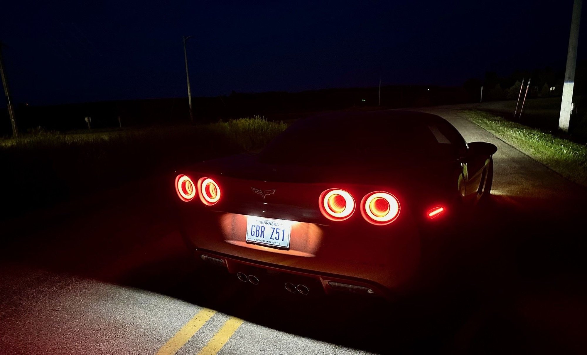

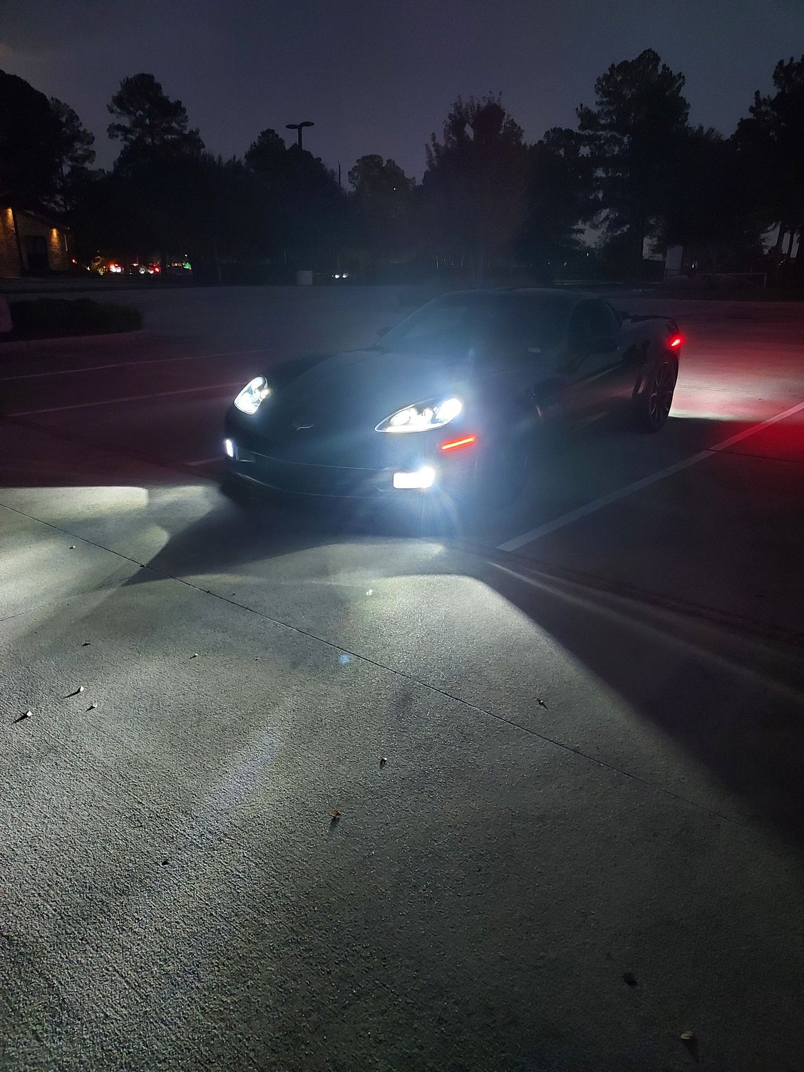

Turn signals f&r can be plug and play if you use add-on harnesses that have built in load resistors. Otherwise, you'll need to wire in the resistors yourself. For all things LED I'd highly recommend forum vendor Sharp Lights Innovations. They have a wide selection of hi quality LEDs and make the harnesses in house.
https://sharplightinnovations.com/
All these exterior lights are LEDs from Sharp Lights

The Headlights, Fog Lamps, Side Markers, Tail Lights, Third Brake Light and License Plate lights are Assemblies, Everything else was bulbs

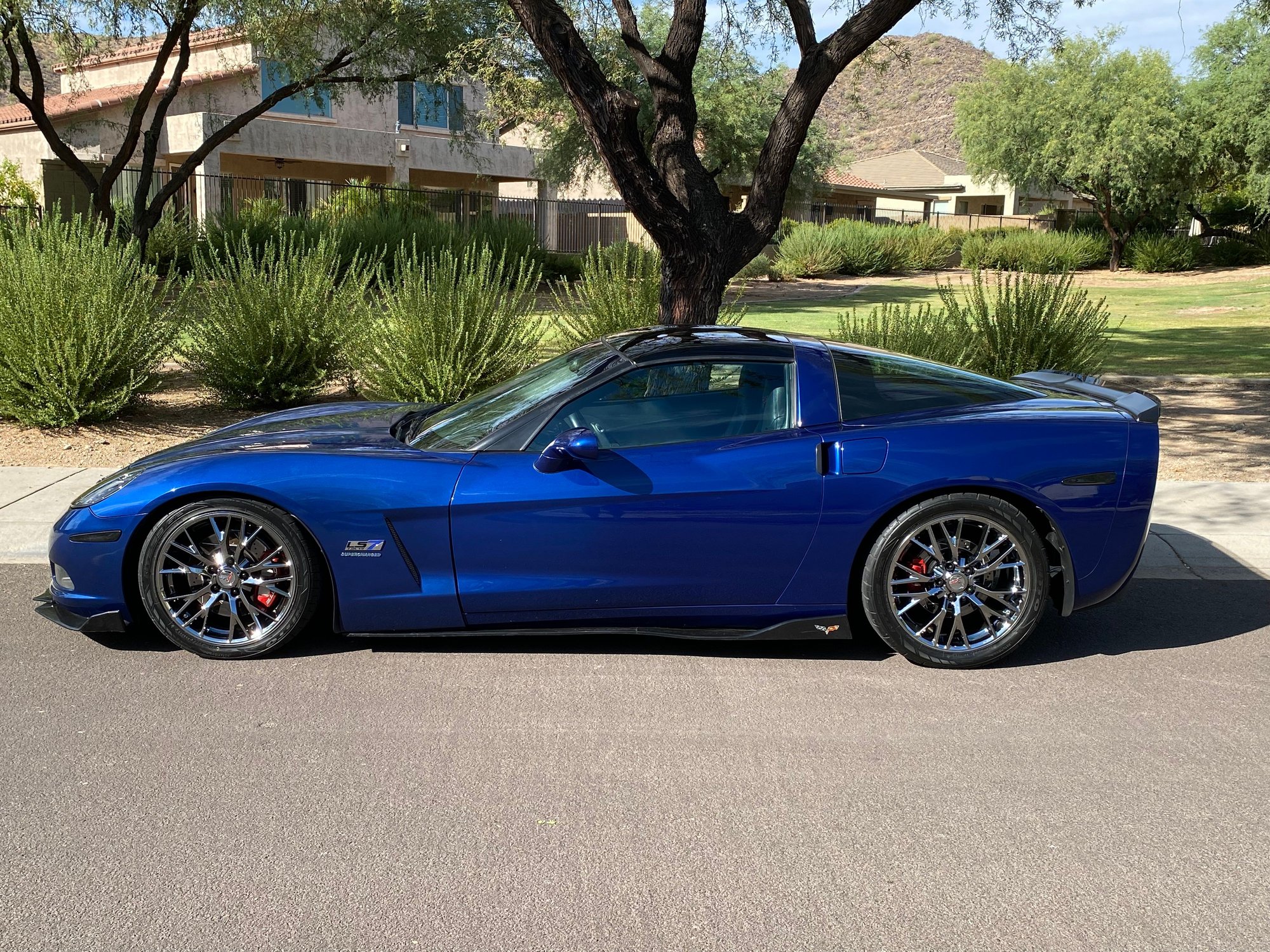

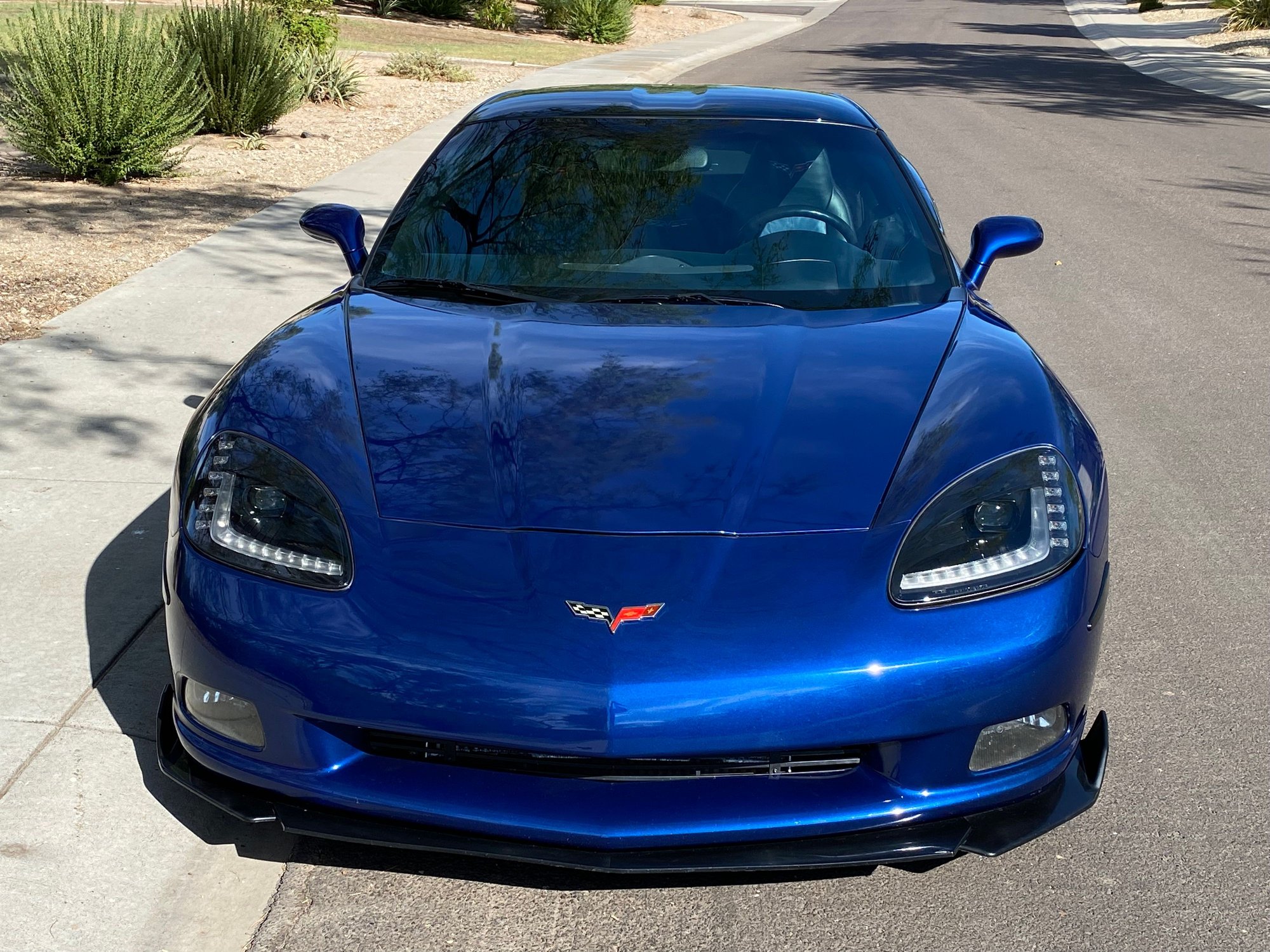

I did exactly the same thing and never looked back. As far as the headlights........the Morimoto's are a MAJOR improvement in not only night vision, but also in looks. I hate the "bug eye" look of the stock lights, and they are terrible at night in comparison to the Morimoto's.
The Morimoto's are much better that the OEM headlights for illumination and of course the look is amazing
Used the black out LED tail lights too
And the side marker black out LED's complete the look
